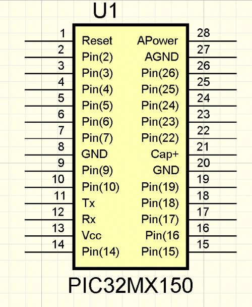

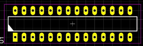

Hi Jim,
I couldnt find my original PIC32MX150 part so I created a new one.. I spent about 40minutes looking for the old one to then edit it and in the end started afresh and only took about 15min to do from scratch (had to teach myself some things again like how to add the text to NAME the pins)
Here is the part
2014-07-06_022733_PIC32MX150.zip
This is the schematic and footprint.. If you want some changes let me know
PS. Extract the part and put it in the library somewhere (I created a Library called Mik)
The location for my library is under C:/Users/mik/AppData/Roaming/AutoTrax Software/Dex/Library/Catalog1/Mik
Remove any spurious spaces TBS wants to add in the long string above but I am sure you get the idea.
EDIT***
I realised after I made this post I left the ) off the end of the pin(16) name so I have updated the part in the ZIP above so unless you downloaded it within 5mins of this post the part will be correct for you.
Edited by bigmik 2014-07-07

Posted: 10:39pm 05 Jul 2014
Jim, Mick
Slight correction needed gents to the schematic labelling . Pin 19 is GND, Pin 20 is Vcap, Pin 21 is Pin(21).

Posted: 11:06pm 05 Jul 2014
Thanks Phil,
Thats what happens when you rush,
Cant fix it now, out of time, but will tomorrow,.
Glad someone is awake.
