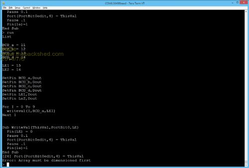

I am setting up a system to drive two large 7 segment LEDs and the PORT command is giving trouble!
See this screen dump
I hope the image is OK as I do not know how to capture the code as a text file.
As you can see the interpreter thinks Port is an undeclared array.
What am I doing wrong?

You could ZIP the image and upload it as a file. We would have some chance of reading it.
I did the same as plasma and magnified the image and I could read enough to know that you only are showing us part of your code.
You have used the PORT command more than once. Does it fail at each instance or which instance does it fail at? The error shows that it fails at line 26. If you don't know which line that is then invoke the editor when you get the message and it should position the cursor at the failing line.

From zooming in on your screen dump, it looks like you may be having variable names beginning with function names. For example, you use the variable name 'PortBit0edit' (I think it reads), but I would not advise this as it begins with a function name (i.e. 'Port').
Try changing any variable names that have a function name at the beginning and see how you get on. In the meantime we await a better screen shot/listing (see Bob's post above regarding zipping image).

I think we have the whole program, the first line is LIST.
In the SUB declaration you have named a variable PortBit0 and in the PORT command within the sub you have used PortBit0edit which would be Null or 0 and therefore a illegal port and perhaps results in the error.

I think the line has an extra word 'edit' as part of the variablename.
[code]
Port(PortBit0edit,4) = ThisVal
'should be:
Port(PortBit0,4) = ThisVal
[/code]
Ahum, that was what AJKW already found. :)

I have run your code on a 44-pin MicroMite (modifying the code to use valid MicroMite pins) and can report the following:
1> When using the 'incorrect' variable name PortBit0edit, an 'Invalid argument' error occurs.
2> When correcting variable name to PortBit0, the program runs fine.
Please note that as stated in my previous post; it is not good programming practice to use function/command names at the start of variable names. It does happen to be ok in this case on my MicroMite module but I would still recommend changing any variable names that begin with a function/command to something else.
By the way, the last line in your sub looks like 'Pin(16)=1'. Should this be 'Pin(LE)=1'? If you do actually want Pin16 then why not use Pin(LE2) since you define LE2 as 16. I am not trying to 'correct' your code - just highlighting a potential issue that you may have overlooked.
