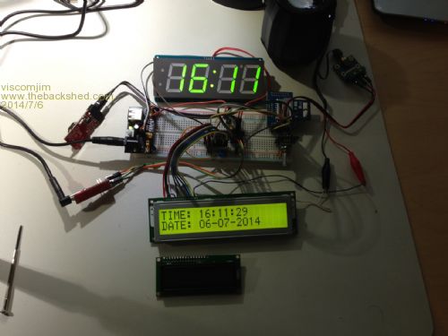

Just a quick project...
Friend wanted clock with Tibetan bells on certain time markers. Here is uMite with adafruit 7 segment LED 1.2" display (I2C), olimex mod rtc (will be switching to ds3231 for better accuracy), MDfly mp3 module for sound, serial connection, single encoder with push button for menu, time, sound, volume, etc. settings. The large lcd will not be part of this project, I just wanted to show this as it is a great deal from Jameco or Ebay. It is an extra large 2002 display for about $5.00 ea. The lcd below it is a 1602 for size comparison. Could be good for a few projects, especially at that price.
Just having some fun with uMite. Thanks again Geoff and forum members for all your help once again!

This looks pretty cool.
do you have any sample code to share how you drove the seven segment through i2c?

Hi David,
Here is basic code for time clock using this adafruit display.
'ADAFRUIT 1.2" SEVEN SEGMENT LED DISPLAY ON I2C
'USES HT16K33 RAM Mapping 16*8 LED Controller Driver with keyscan
'http://www.adafruit.com/datasheets/ht16K33v110.pdf
'BASIC DISPLAY CURRENT TIME PROGRAM
'RTC IS OLIMEX MOD RTC ON I2C
'THE BACK SHED - VISCOMJIM
DIM T(10)
T(0)=&H3F:T(1)=&H06:T(2)=&H5B:T(3)=&H4F:T(4)=&H66 'SEGMENT DATA FOR 0 - 4
T(5)=&H6D:T(6)=&H7D:T(7)=&H07:T(8)=&H7F:T(9)=&H6F 'SEGMENT DATA FOR 5 - 9
I2C OPEN 100,100 'OPEN I2C PORT
I2C WRITE &H70, 0, 1, &H21 'START OSC. ON DISPLAY - &H70 DEFAULT ADDRESS
I2C WRITE &H70, 0, 1, &H81 'BLINK OFF - DISPLAY ON
I2C WRITE &H70, 0, 1, &HEF 'BRIGHTNESS FULL ON (E0 DIM - EF BRIGHTEST)
COL=0 'COLON
SETTICK 500, FLASH 'SWITCH COLON ON AND OFF 1 PER SECOND
SETTICK 3600000, SETTIME, 4 'RESET uMITE CLOCK USING RTC EVERY HOUR
RTC GETTIME 'SET uMITE CLOCK NOW
DO
HRSTENS=Val(Left$(Time$,1)) 'GET 10 HOUR DIGIT
HRSONES=VAL(MID$(TIME$,2,1)) 'GET 1 HOUR DIGIT
MINTENS=Val(Mid$(Time$,4,1)) 'GET 10 MIN DIGIT
MINONES=Val(Mid$(Time$,5,1)) 'GET 1 MIN DIGIT
I2C WRITE &H70, 0, 2, &H00, T(HRSTENS) 'WRITE 10 HOUR DIGIT
I2C WRITE &H70, 0, 2, &H02, T(HRSONES) 'WRITE 1 HOUR DIGIT
I2C WRITE &H70, 0, 2, &H06, T(MINTENS) 'WRITE 10 MIN DIGIT
I2C WRITE &H70, 0, 2, &H08, T(MINONES) 'WRITE 1 MIN DIGIT
LOOP
SETTIME:
RTC GETTIME
IRETURN
FLASH:
IF COL = 0 THEN DOT = &H00
IF COL = 1 THEN DOT = &H02
I2C WRITE &H70, 0, 2, &H04,DOT
IF COL = 1 THEN COL = 0 ELSE COL = 1 'FLIP COL ON OR OFF
ENDIF
IRETURN

Hi Jim
i bought an Adafruit 7 segment LED 1.2" display
but when i hook the 5 volt supply from my Maximite
to the display i2c communication stops.
I assumed the display draws to much current
for my maximite to handle.
Do you have a seperate 5 volt power supply to your 7 segment LED 1.2" display
i cant tell from the photos.
Thank you.
Graham
viscomjim
Joined: 08/01/2014
Posts: 925
Posted: 04:07pm 24 Nov 2015
Hi Graham, I did power it with a separate power supply. I did not use the Maximite however, so you might have to make a few changes in the code. I did start with the Maximite back in the day, but now I do everything with the micromite, including this project.
I am sure you can adapt the code to make it work.
Good luck and let us know how you make out.

@shellgray;
When driving these 7-seg/matrix displays, I find it best to use a separate psu. The 8x8 matrix I am driving at the moment can peak at 350mA requirment (when at max brightness).
Also, just to check, you cant drive the segments directlly from a Mite's pin; you will need a 'driver' to deliver enough current. I typically use a MOSFET (2n7000/2) with gate to PIC (via a 470ohm resistor), source to GND, and drain is then the switched GND to the LED. Use a P-channel if wanting to switch high side.
Hope you get on ok - any more help you require then simply post your 'issue' here. There's enough people on this forum that will be willing to help you. . . .
