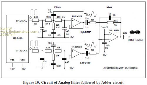

DTMF dual tones may be generated using the Micromite PWM outputs as F1fco has demonstrated above. The distortion specification for the tones is not onerous with distortion to be at least 20 dB below the lower tone. However without filtering the square wave output will exceed this, likely limiting reliable performance. Below is a filter circuit, borrowed from a Texas Instruments application note, where square waves from two processor outputs are combined to give the sum of the two frequencies. This filtering is performed within most DMTF generator chips.
