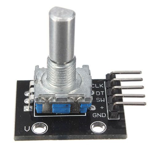

Hi
The KY040 Rotary Encoder module is widely available on eBay for less than US$2.00 inc P&P to UK, See Link
Anyway, here's some demonstrator software to show how to wire the KY040 up to a uMite and use it. The code is also available on MMReference.com Thanks David.
Hopefully this code will help more people to use Rotary Encoders with their uMites.
73
Peter
' Rotary Encoder (KY040) Demonstrator
' MMBasic 4.5 or newer.
' (c) Peter Carnegie 2014
' The KY040 module contains a rotary encoder together with a push-switch on a small
' PCB with 5 Connections. The KY040 was developed for Arduino, but of course us uMite
' folk can use it as well, and the KY040 is incredibly cheap, US$2.0 inc P&P, just
' search eBay for KY040.
' Wiring it up
' KY040 Micromite
' CLK 2 ---> 0.1uF ---> Ov
' DT 3 ---> 0.1uF ---> Ov
' SW 4 ---> 0.1uF ---> Ov
' + 3V3
' Gnd 0V
' NB
' 1) It is VERY important to decouple the DT,CLK & SW pins to 0V
' using 0.1uF at the uMite end of the link wire.
' If you don't decouple these signals, severe contact bounce will be evident,
' eg one click will generate a dozen or more increment/decrements.
' 2) The KY040 module has on-board pullup resistors. You must supply 3V3 or less
' to the + pin of the KY040 module
' 3) This s/w works fine with just a standalone rotary encoder, but you will need
' to supply your own 10K pullups to 3V3. For a standalone encoder RA=CLK, RB=DT, & SW=SW
' When this software runs, each CLOCKwise step of the rotary encoder will result
' in an increase of the variable DisplayValue which will be printed to the Console.
' Each ANTI-clockwise step of the rotary encoder will result in a decrease of the
' variable DisplayValue which will be printed to the Console.
' Pushing the push-switch will clear the variable DisplayValue to 0.
' This demonstration s/w is Interrupt based for maximum responsiveness.
' This software improves on the snippet listed
' in the Micromite User Manual in that the count, DisplayValue
' increases/decreases more smoothly/accurately.

Hi Peter,
I bought the same encoder module on e-Bay, so thank you for the description and the code. I'm using right now an optical encoder (Bourns ENA1P-028) purchased a couple of months ago on eBay for a bargain price(~$6 + shipping). Although optical encoders are designed for 5V they work with 3.3V as well.

I'm assuming that you are referring to the AD9850Controller software I published on TBS ?
1) I can't find line 218 which says CurFreq$(1)=CurFreq2Asc$()
2) Are U using MMEdit with Auto-Crunch and "Delete Blank Line" set ON ? Could you please make sure that MMEdit is configured with "Delete Blank Lines" set to OFF so that my source line numbers and your source line numbers line up.
3) I think your line 218 may be referring to my source line 420, in which case try changing line 418 LOCAL CurFreq$(1) Length 8 to say LOCAL CurFreq$(1) Length 10

G8JCF
Joined: 15/05/2014
Posts: 676
Posted: 06:05am 13 Jul 2014
@boss
I pasted your source into MMEdit, but line 218 says Cy=0, and also the step sizes in the code you posted seem to be the same as the original, ie
'Array of Possible Step Sizes in Hz
Dim StepHz(4)
StepHz(0)=1
StepHz(1)=10
StepHz(2)=100
StepHz(3)=1000
If you need larger step sizes then proceed as follows
1) Increase the size of the StepHz array, eg
Dim StepHz(6)
StepHz(0)=1
StepHz(1)=10
StepHz(2)=100
StepHz(3)=1000
StepHz(4)=10000
StepHZ(5)=100000
2) Increase the number of Step Tuning Words, eg
'What to Add/Subtract from the Scaled tuning Word
'for each Encoder Up/Down
Dim StepTWord$(6) Length 24
'These TuningWord sizes were calculated using Double precision arithmetic
'in VB6, using 2^32/125.0
StepTWord$(0)="34359738" '1Hz 34359738.368
StepTWord$(1)="343597384" '10Hz 343597383.68
StepTWord$(2)="3435973837" '100Hz 3435973836.8
StepTWord$(3)="34359738368" '1000Hz 34359738368
StepTWord$(4)="343597383680" '10000Hz 343597383680
StepTWord$(5)="3435973836800" '100000Hz 3435973836800
3) In SUB StepChange make the modification to accommodate the extra step sizes, eg
Sub StepChange
CurStepIndex=CurStepIndex+1
'Roll round CurStepIndex if greater than 5
CurStepIndex=CurStepIndex Mod 6
'Load the CurStepTW with the Step in TW
LoadBCD CurStepTW(0),StepTWord$(CurStepIndex)
'Could display something on the LCD to indicate New Step in force
'eg Underline digit.
End Sub
$) Also you could change - simply for neatness
line 98 SETPIN RSW, INTL, Roll
TO
Line 98 SETPIN RSW, INTL, StepChange
and delete
Roll:
StepCHANGE
IRETURN
Did U try the Gearing/Ratio suggestion in my last post ?
That should do it, the frequency should never be longer than 8 digits when using an AD9850, the highest frequency the AD9850 can generate with a 125 MHz clock is 125/2=62.5 MHz clock, and with these eBay modules anything above 30 MHz is not really worth using.
