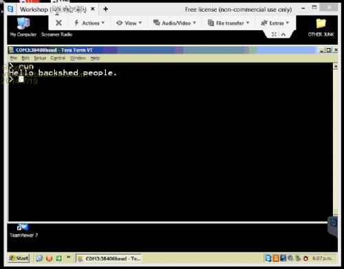

This may not be the most efficient way to do it, but it sure works, and is how I am going to implement remote access to a couple of projects.
MicroMite pluged into remote computer, which is running TeamViewer.
Connect to the remote computer from your main PC using TeamViewer, and you can type away there accessing the remote copy of TeraTerm.
Perhaps not the most efficient(in that you need another PC as a go-between), but it works, and all you would need would be a cheap old PC or laptop with Internet access and TeamViewer.
This example shot is of a uM plugged into the workshop computer, and the workshop is on the other side of the city - works like a charm, and so easy.Edited by Grogster 2014-07-20

Grogster, I did a similar thing using an old Pentium 3 laptop running xp pro and accessed it via remote desktop. A PC or lappy running Windows 2000 will still work at the remote end.

Yeah, GM, that is the beauty of it.
