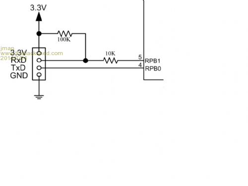

I see where ps2 and composite hook up .....
Where does MicroMite (and which pins?) hookup ?
BobD
Joined: 07/12/2011
Posts: 935
Posted: 06:38pm 23 Jul 2014
  hitsware said   Where does MicroMite (and which pins?) hookup ? [/quote]
They hook to CON1 at the bottom left corner of the image.Edited by BobD 2014-07-25

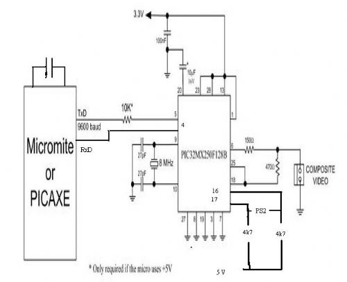

Posted: 04:51am 24 Jul 2014
essentially: ?
Posts: 3003
Posted: 09:15am 24 Jul 2014
Looks ok apart from cap on pin 20. IF you use a tant then polarity is +ve to pin 20 and -ve to gnd. OR use a ceramic multilayer which are cheaper and better (longer life).
