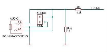

Hello all,
I'm struggling to find info regarding the hardware hack to allow the full PWM signal from the sound output.
I've got a standard Duinomite, as well as a Mega. Ideally I'd like to switch the output level to suit sound OR PWM.
Has anyone got a closeup shot of the board and could circle the offending components for me? I have tried in the past but couldn't be 100% certain, and now I actually have need of the PWM output.
Thanks for any help.

I have Mega.
You can see R39 needs to be removed
(trusting schematic and silkscreen)
R39 and designator are easily seen
on board just behind the audio out jacks.
I have removed similar by breaking
off with ice-pick ...

In order to make Color Maximite switchable (audio or pwm)
1) Remove R14 and R16
2) Connect 0.1uF capacitor from L #1 output to MMBasic pin 1
3) Connect 0.1uF capacitor from R #2 output to MMBasic pin 2
4) For audio (TONE or softened PWM):
SETPIN 1, DOUT
SETPIN 2, DOUT
5) For PWM (fastest switching)
SETPIN 1, OFF
SETPIN 2, OFF

I finally got around to removing the 1k pulldown resister from my DM. Although on my standard DM it's r42, not R39 as with the mega.
Some testing resulted in the following:
PWM output tested with multimeter and voltage 0 through 3.3V depending on duty.
H-bridge wired as per diagram, and if I short it's PWM input pin to 5V the motor works
However, the DM PWM output won't drive the motor?
On the standard DM, the current limiting resister is R39 and 5.6K. Does this need to be bypassed? Or have it's value reduced?
I guess I should just try it and see, but I was hoping someone might be able to confirm or deny before I go messing around lol
Thanks everyone
For a motor you need to try as much current as safe.
I'd say 100 Ohm resistence PWM pin to motor .
If no movement then you need active current boost .

The first resistor I grabbed out of my junk box was 120 Ohm which worked a treat. In the end I decided not to bother making the output switchable. I think I'll just add a piezo for error beeps and remove the need for audio output.
Just need to code up the full package now. Proportional fan control to maintain a set temperature in a heat exchanger.
