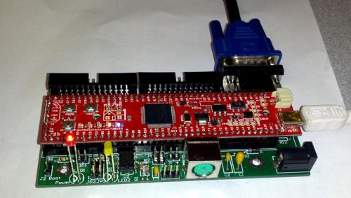

Posts: 2981
Posted: 12:12am 19 Aug 2014
Grogster,
What extra are you catering for on your board?
The UBW32-MCC that Don Sells is pretty small, maybe the extra bits you want could be designed as plugin via the 2 x 26pin headers along one side
The 2 headers are along the rear edge next to the VGA connector.
Posts: 2981
Posted: 12:15am 19 Aug 2014
Damn I hate the way TBS reduces pictures.
Here is the same picture ZIPPED up.
You can just see R12 under the UBW32 on the RHS and that it is a soldered link (not all of it is visible)
2014-08-19_101515_UBW_plugged_in.zip
