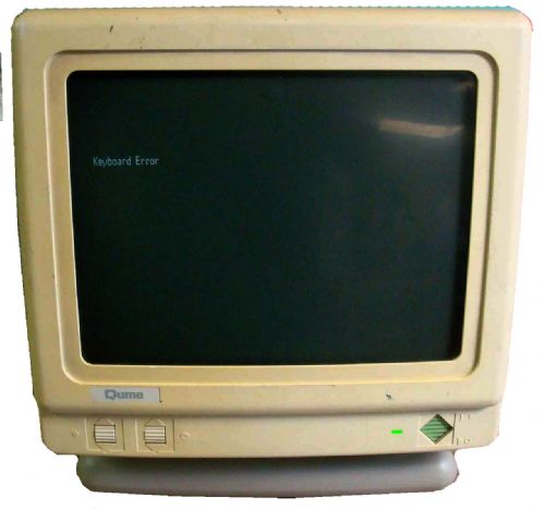

Posts: 2984
Posted: 12:07am 04 Oct 2014
  JohnS said   I hated it as I was used to better devices; for me it had a horrid little screen and a nasty keyboard
Yes until recently we used these horrible QUME QVT-321 VDUs
Now we use HP PCs with a SFF PC bolted on the back of the LCD Monitor and run PowerTerm for Windows. Much better and more reliable.
