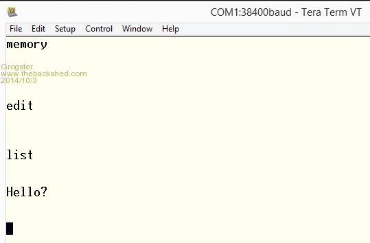

This on is weird....
150 uM chip(28 pin), working just fine last night, then I had a power glitch caused by my not pressing the power switch right - would have caused quite a lot of noise on the power supply.
Now the uM is totally dead.
God bless the console, so I connected that up, and no program anymore, no edit anymore, no commands at all anymore.
BUT - the serial interface still works at 38k4, it's just the uM won't process anything.
Fully regulated and decoupled supply - I think the problem was just my mistake of holding the switch half on, which would have produced very dirty power to the unit, but I figured that the regulator and decoupling caps would have saved the chip, but perhaps not?
This is all I get when I connect up the terminal:

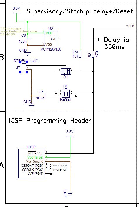

I am sure it is caused by the same issue as in this topic:
http://www.thebackshed.com/forum/forum_posts.asp?TID=6512
If this still happens then it means the routine to check for a short between the Rx and TX is not robust enough in all cases. Personally i would like that there would be no such routine at all, to prevent this even in rare situations. Murphy's law says it will happen when you least expect it.
To prevent such things i always use a supervisory chip that holds the microcontroller in reset while powering up.
like this (i use the mcp120):
Posts: 4386
Posted: 10:33pm 03 Oct 2014
Looks good.
