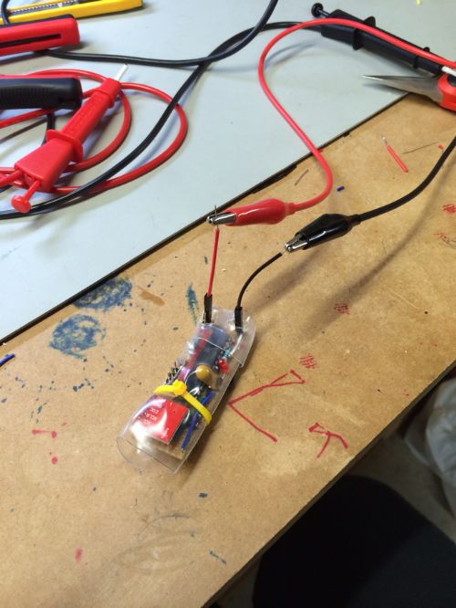

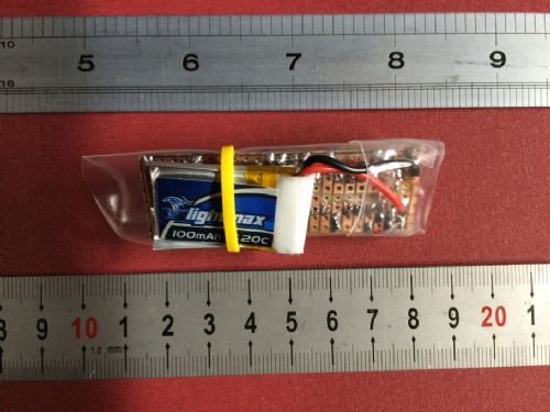

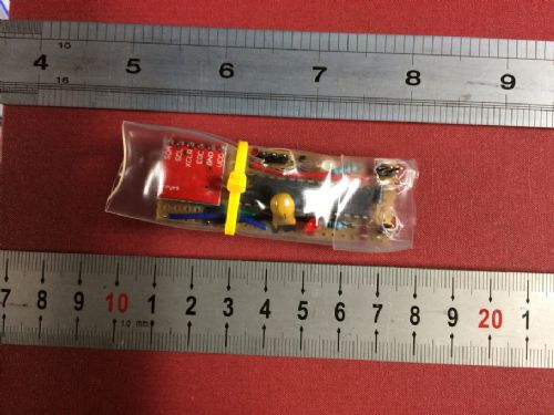

My first micromite project is complete - a model rocket altimeter. Fairly bare bones really - just the micromite, a BMP085 pressure sensor, and a pair of LEDs (more for debugging/testing), powered by a little 100mAh 1S lipo. I incorporated a 1N4001 in series with the battery to drop the voltage to 3.3V.
The on/off 'switch' is a jumper, which, when removed clears a header pin that I can charge the battery from.
I haven't included a display (weight/size reasons), so just power off the altimeter, connect to laptop via serial, turn on - the first part of the program displays previous flight data saved in the flight.
The most enjoyable electronics project yet!

Hi LeeIII, nice project!!!! Can you provide some more details and results. Very good use of uMite.

101 uses for heatshrink - a project box!
Nice one.
I'm glad you are enjoying yourself.(as I am sure, is everyone else)

A very interesting project any chance of some pictures of the type of rocket used and the software to produce the results that you obtained.

The rocket is just a little hobby rocket - cardboard, 32mm diam (I think) weighs around 90g.....
The software - the output I posted is a cut/paste from the terminal emulator.
I'll post the program in a moment - the guts of it ie driving the BMP085 is from TassyJim's code on mmreference - I added the parts to collect/analyse data.
