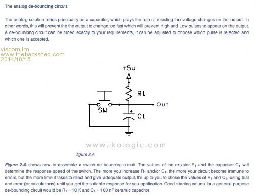

viscomjim
Joined: 08/01/2014
Posts: 925
Posted: 04:20am 15 Oct 2014
I have used this with no problems, works weil with uMite...
R1 = 10k
C1 = .01uf or .1uf
atmega8
Joined: 19/11/2013
Posts: 738
Posted: 04:47am 15 Oct 2014
sorry, but how should this work?
The c1 is her only important for generating some sparks and demaging the switch;-)
What is your config on the pin Interrupt?
viscomjim
Joined: 08/01/2014
Posts: 925
Posted: 06:53am 15 Oct 2014
I typically do SETPIN XX, INTL, SWITCHINT.
XX being the pin number and SWITCHINT being the interrupt routine I want to execute.
Here is some info from this forum.Edited by viscomjim 2014-10-16
atmega8
Joined: 19/11/2013
Posts: 738
Posted: 11:38am 15 Oct 2014
Ok, my answer was a little bit to fast......
After thinking some minutes about it i agree that this can do a good debounce job;-)
I will Test this ..
THX

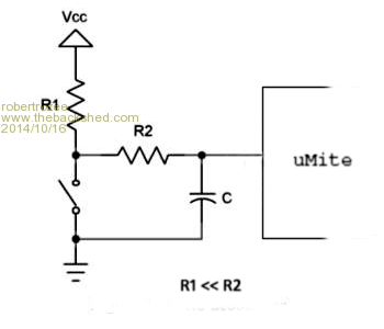

someone earlier posted a link to a page containing this circuit:
it addresses your concern about shorting out the capacitor (in theory a quite valid concern), and provided R1 is much less than R2 then ramp up and ramp down times will be fairly similar. the micromite digital inputs almost certainly go through schmitt triggers, so this circuit will work well.
t = 0.7 x R x C (approximately)
for t = 1mS, reasonable values would be R1 = 1k5, R2 = 15k, and C = 0.1uF. while the button is held pressed about 2mA will flow if R1 = 1k5.
rob :-)

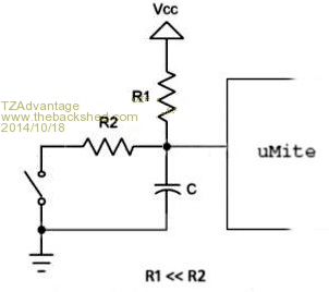

My entry to the "competition":
[Modified picture from Rob]
!Note R1 = 4 x R2.
While the switch is closed it draws less power as both resistors are in series.
The two resistors are a basic voltage divider when the switch is closed, so it works even with an analog input.
Because it being a voltage divider R2 needs to be small enough to get a 'low' on the input pin. My estimate is that R1 has to be about 4-5 times higher in resistance then R2.
In battery operated systems that have switches that can be closed for a long time it will give some more live.
Edited by TZAdvantage 2014-10-19
Posts: 2556
Posted: 02:15am 18 Oct 2014
  viscomjim said   I am now curious to see which one actually works?
under most circumstances, they both probably will perform equally well. with the switch shorting the capacitor directly there will be a very small arc if the contacts bounce, which will serve to maintain the short throughout. but this arc will be so small as to do no real damage to a switch actuated by a person.
however...
some years ago i set up an experiment to monitor startup durability of a power supply design. startup was normally initiated by a conductive-rubber push button being pressed by the operator, but for the purposes of the experiment this was replaced by a rather large relay driven by a timer that fired briefly every 10 seconds. the output of the power supply was connected to an electro-mechanical counter. because the power supply had no 'heartbeat' signal being sent back to it (from the rest of the product), by design it would shut down automatically after a few seconds.
the end result was that every 10 seconds the power supply would be turned on, which would then increment the counter. after a few seconds it would turn off. the power supply itself was sitting in a thermal oven, that over a period of several hours would cycle between a high of 85 degrees C and a low of -10 degrees C. every day i would check the counter was still going up and that nothing had exploded.
to my complete bewilderment, after about 8 months (heading up towards 2 million cycles) the setup stopped working. i traced the failure to the (20A) relay contacts connected in place of the power switch, which were massively eroded. the relay had 3 sets of contacts, with only the one set being damaged.
the conclusion - root cause analysis: the tiny capacitor in the switch debouncing circuit (just a single resistor and a capacitor) had very very slowly eaten away the relay contacts through the around 2 million tiny arcs the experiment had created.
the moral of the story: if you expect your switch contacts to be closed several million times over the life of your project, it would be prudent to use a second resistor. but, in practice, this is only likely to be an issue if some sort of machine is actuating the switch repeatedly.
rob :-)
