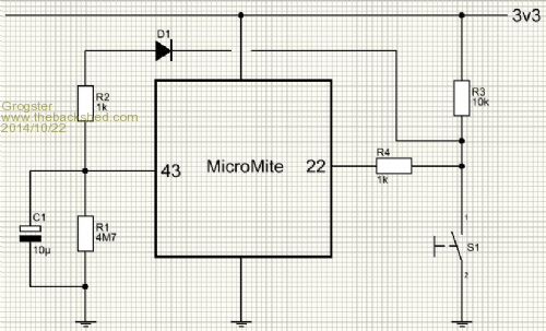

Posts: 10043
Posted: 01:39am 21 Oct 2014
OK, I have made the changes, and have a cap and resistor in parallel.
For testing, I am using 330pF and 1M5 in parallel.
Code runs into first CPU sleep command, then never wakes up.
Cap and resistor from pin 43 to ground.
Pin(43)=1 at start of loop to charge up the cap.
EDIT: OK, got the uM cycling again, but I had to remove the resistor in parallel with the cap. With the resistor in place, the uM never wakes up.
Any further suggestions?Edited by Grogster 2014-10-22

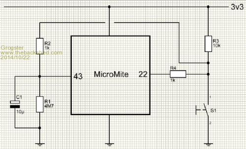

Posts: 10043
Posted: 06:43pm 21 Oct 2014
OK, with your 220k and 10uF, I can get the same results as you.
I guess 1M5 was too high a value?
Would I be correct in my assumption that lower value caps with high-value resistors is the preferable arrangement over large value caps and lower value resistors?
I will play around with this idea more.
EDIT: OK, with 10uF tantalum and 4M7 resistor, I am getting about 45 seconds sleep time. If I went down this road, I would be using an X5R 10uF MLC capacitor - the same cap I use for the uM Vcap. Being X5R, it should be reasonably stable over time and temperature.
EDIT: OK, I seem to have found out that under certain circumstances, the uM seems to just stay asleep forever. When I try to use my button to wake the uM, it does not wake, then it NEVER wakes. Example: Apply power, run code. uM starts sleeping and waking as it should. While asleep, try to wake it with the button across the wakeup pin and ground, uM does not wake, and then the uM NEVER wakes no matter how long you wait. To get it back, I have to cycle power or press the RESET button(I'm using a WW 44-pin module)
This does not happen with the 7555 driver circuit. Witht the 7555, the uM sleeps and wakes on command, and also can be woken any time with the button.
Something about the cap + reistor idea which does not want to work in a reliable sence, as was initially pointed out by Geoff.
EDIT: Ahhhhh - forgot the 1k series resistor between the WAKEUP pin, and the switch to ground. I can wake the uM on button press now.
EDIT: OK, here we have the circuit as it stands now, and this seems to be working fine, including waking on command when S1 is pressed.
Edited by Grogster 2014-10-23
