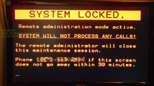

Playing around with the VT100 tonight. I plan to use this as a static message display when I use the Internet to remote-administer a CMM-based system. The VT100 board shows this message, and switches a KVM switch to switch the actual VGA side of things, and also isolates the local keyboard, so staff can't interrupt or otherwise upset the remote access of the system.
I have blurred-out the phone number for reasons of privacy, but I really do LOVE these two large text modes on the VT100 terminal.
Image looks orange, but that was the camera and low-light. Text is bright red.

It has a nice retro 1970's look to it.
