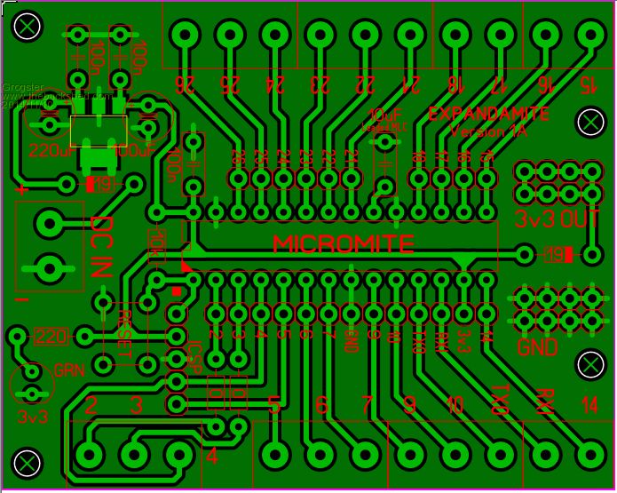

Posts: 10052
Posted: 11:47pm 09 Nov 2014
How about this Rob? (and OP, naturally!)
Single-sided, all through-hole parts except for the 3v3 regulator, which is SOT-223, and big enough for it not to be any problem to solder.
PCB terminal block connections on outer edges, pin-headers close to chip, ISCP, on-board regulator and DC output bus-bars. The only thing I could not squeeze in, was the DC socket, but this is the first attempt...
Edited by Grogster 2014-11-11

Posted: 12:18am 10 Nov 2014
Hi Grogster
Still a wee bit too small IMHO. But the really important thing is that there needs to be a 0V terminal for every I/O terminal adjacent to the I/O terminal (or use double stacked terminal blocks if length is an issue), otherwise the wiring on the field side tends to become a real mess.
Peter

Posts: 2552
Posted: 01:08am 10 Nov 2014
the problem with ground connectors for every i/o is cost (for the DIYer), as well as much increased PCB size if using 0.2" screw terminals.
grogster: what you have come up with is very close to what i had in mind. but (of course!) there are a few changes i'd suggest:
1 - bring the console out to just a separate 6-pin 0.1" header with 5v, 3v3, TxD, Rxd, gnd. use 6-pin as the back shells are far easier to obtain than 5-pin.
2 - i'm wondering if ICSP can be dropped. there are already the pin headers there, so building a cable to plug into these for programming might be sufficient.
3 - remove the 3v3 trace under the micromite. replace it with a wire link. the trace divides up the ground plane to create a couple of rather nasty looking ground loops.
4 - i much favour a TO-220 regulator, LM1117-3v3 or similar. even if just providing the 3 holes for the TO-220 pins laid over the SOT-223 footprint.
below is a terminal layout i came up with last night, very similar to yours:
rob :-)
Posts: 10052
Posted: 01:18am 10 Nov 2014
Yep, I can look into that. I'm just playing around, really.
As to the regulator, I looked at Jaycar, but they only do a 50mA regulator that can accept 9-12v input. 50mA would probably do, but I figured a bit more capacity would be handy for powering other 3v3 things you want to connect to the uM circuit.
Jaycar don't seem to sell the 1117, but element14 do here.
WHY do you favour the 1117? The SOT223 reg I have designed in is a Microchip MCP1703-33, and they have a wide input voltage, very low dropout and standby current, and only cost 72 cents each.
I don't really care what reg is used, but I am just curious why you favour the 1117.
Is it cos SMD soldering is too scary?
