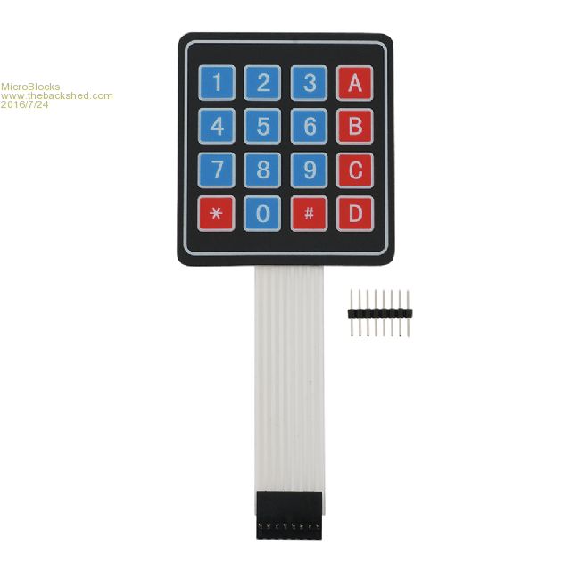

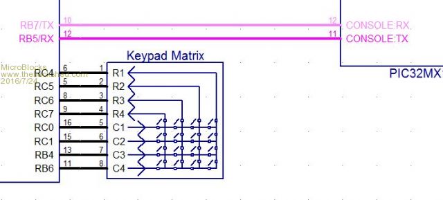

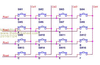

Posted: 06:08am 24 Jul 2016
I am currently testing something different that might make a good solution for adding switches/keypad.
I have added the code for scanning a little matrix to my USB/Serial converter.
It has an 8 pin connector that directly connects to those membrane keypads that have a 4x4 matrix.
like this one:
You can also use it to connect switches of your own, just wire them as a matrix. 1 key to 16 keys supported.
The extra code scans the matrix and injects a switch/keypad code into the outgoing serial buffer.
The micromite will receive it over the console rx and can treat it like any other key just as ones that are pressed on your pc's keyboard when using a terminal.
I am considering to use the normal ascii codes for it, or as an alternative send ascii codes 200-216 to distinguish between keypad and pc keyboard.
