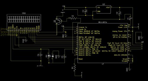

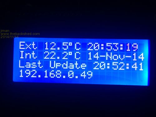

Hi
Here is a little project I have been working to monitor the temperature in our server room at work. We hardly ever go in there so I thought we better keep an eye on the cooling.
I chose to display the temperature and some other info on a 20x4 LCD this will mounted in the server rack. Should a fault occur the Micromite will send an email to me every 4th cycle (this is a user setting). I am using 15 minutes at present so i get an email every hour. The temperatures are uploaded to www.thingspeak.com every 15mins. To use this you will need to create a free account @ www.thingspeak.com and put your api key in the relevant place. To connect to the internet I am using an ESP8266 Wireless module these are really cheap and easy to use. Put your Wireless SSID and password in the relevant place if your connection is successful the terminal and LCD will display the assigned IP address.

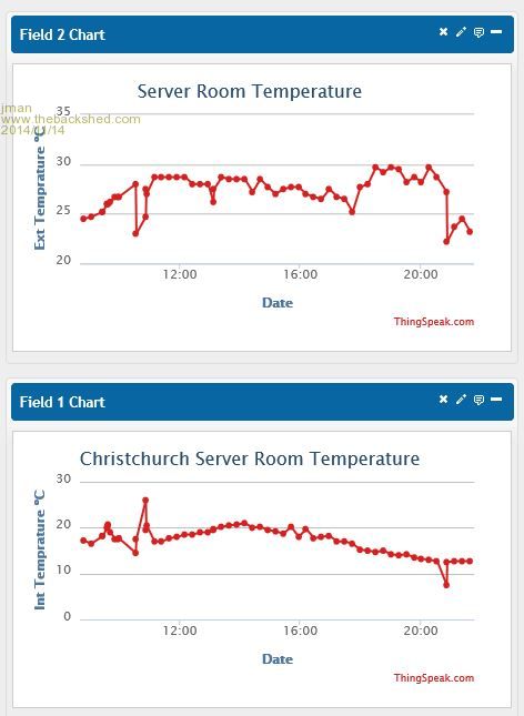

Sample screen shots below. The shown temperatures are not the server room temperatures they are my outside my window and the test bench :)
The date and time are from the returned connection string the thingspeak.com sends back the temperature sensors are DS18B20's
Please take a look and post here if you see any dumb mistakes or things that could be done better.

Great stuff JMan - I've got a mate who asked me if if he could remotely monitor how his heating system was going in different zones of a building of serviced offices he owns. Not sure how he'd change the control settings remotely if there was a problem but I guess he could ring someone up in the building to do it manually!

Hi Jman, This is very cool. I always wanted to try the thingspeak site and now I have a reason!!! Great work!

PWM 2, 1800, 5, 20 'Adjust Freqency for contrast adjustment
directly connected from the uMite to the LCD pin 3 to adjust the contrast instead of the usual 10k pot from ground to +5v? If so, does the 3.3v output work ok for that?
jman
Joined: 12/06/2011
Posts: 711
Posted: 08:43pm 18 Nov 2014
  viscomjim said   Hi Jman,
Quick question... are you using this
Well spotted
This way I can run the LCD from 3.3v and still get good contrast
take a look at this 3.3v Contrast
Let me know how you get on
Jman
viscomjim
Joined: 08/01/2014
Posts: 925
Posted: 10:44pm 18 Nov 2014
Hi Jman, this is quite a cool way to do that and I will implement this on a future 3.3v only project. I am assuming the backlight works ok with 3.3v also? And as Grogster mentioned this can also be pwm'ed for brightness, assuming you are driving a transistor of some kind?
Since I have to use 5v for another component, I can still run 5v to the display. Will this contrast also work as a direct connection (without the caps and diodes)to a pwm pin that's at 3.3v?
@Grogster, you mentioned the pwm for controlling brightness in the linked thread. Do you have a description of the circuit and the code you used for this?
Thanks again for all your help. I am having fun sending emails from the uMite to my IMAP email that goes to my phone and computers. I showed this to a friend and his office wants this to monitor a few sensors and email about 8 different people every 20 minutes the status of the sensors. They were quoted a ridiculous amount of money for this and can't believe I can do it for "half the price", hehehe.
I am now working on sending the uMite an email and making it do stuff and sending an email back that it succeeded or failed. The smtp part works very well, now working on polling an imap and by reading the subject line, the uMite will know that the data is for it. I will post code when done.Edited by viscomjim 2014-11-20
jman
Joined: 12/06/2011
Posts: 711
Posted: 11:04pm 18 Nov 2014
@viscomjim
This the code I use for the Backlight
Sub SetBrightness ' Sub To Brightness
PWM 2, 1000, (100-Brightness)
End Sub
And connected like this
If you run the LCD on 5v you can give this a try for the contrast
(Untested a UMite but tested on 16f88)
You might have to adjust the resistor values.
Really keen to see the email code it's great to share
Jman
