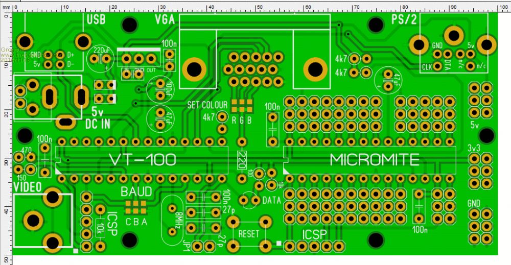

I've been playing around tonight with Sprint Layout:
- VT100 and Micromite in standard DIL format for easy chip swapping if need be.
- On-board sockets for VGA, Keyboard, USB, DC in, and composite video output.
- On-board 3v3 regulator. Diode-gated USB or DC in power supply for the 5v.
- Three strips of header sockets for breadboard jumper wires, small point-to-point circuits or a plug-in daughter-board.
- 5v, 3v3 and ground headers for powering external hookups.
- Baud-rate blob-pads for setting VT100 speed, and blob-pads for selecting VGA colour.
This board is not finished yet - I am just playing, but the idea sprung on me that you may need an embedded MCU with basic video ability all on the one small PCB.
Note there is no ICSP header for the Micromite - you just hook up the wires that are needed at the time you need to re-flash - it's not hard, and should not need to happen that often anyway once the Beta testing is finished.
I am not trying to re-invent the Maximite. I was just playing around to see if I could squeeze it all into a 100mm x 50mm board, which is quite small, yet still keep the VT100 and Micromite chips as standard DIL. Naturally, I have had to use some SMD, but most of it is thru-hole.

Hi Grogster,
Another quality board in the making..
I was just about to send off my artwork for my `corrected' MuP-VT but I think (unless there is a demand) that this would be a more popular option than mine..
A couple of suggestions/observations if I may.
It looks Double sided, which is good, I am not a huge fan of single sided.
If you reduce the height to 49.5mm then you can lay them out 2 to a 10cm square panel with a 0.5mm gap that can be Vee-Grooved and based on Shenzhen2u prices it would only cost you $3 more to double the QTY of boards.
You should be able to add an ICSP header for the uMite along the bottom edge, If you were worried it would conflict with the rows of connections then a R/A header could be installed.. (user choice)

Hi Mick.
Yes, I must say at this point, that I am a new BIG fan of DS(double-sided) board layouts now. I used to do nothing but SS boards, mainly cos I could not do DS board prototypes here at home, but with the price of those overseas PCB houses....
You can't really argue against getting ALL your boards done professionally.
Did you have to tell Shenzhen anything special to get them to V-groove your boards?
As you probably read, I have them making the other SS board we all developed on the other thread, so we'll see when they get here, and what they look like.
As to your suggestions, yeah, I will have a look at squeezing the board height-wise to get two into a 100x100 panel. I also agree about the ICSP header for the Micromite, and looking at the board again today, I also thought the same thing, but you beat me to it!(by suggesting it here before I could)

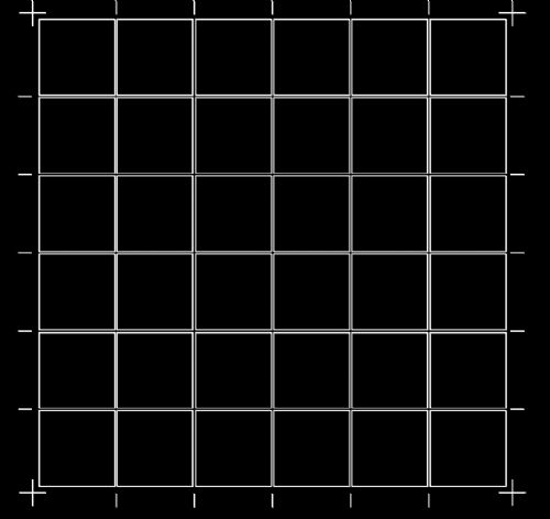

I didnt tell Shenzhen to Vee Groove, BUT... Here might be the kicker
They ask for the GERBERs in a particular format ie. Board outline is name.GML When I create my panelised boards with Autotrax DEX it creates names that are descriptive like
Bottom Silkscreen.GBR
And the closest I have to Board Outline is Board Profile with Cutouts.GBR so I rename that one to their convention. When I view that one I get a picture like This.
As you can see it is NOT a board Profile (as I would have understood it to mean) but it looks like Shenz uses this information as a Vee Groover.
What does Sprint produce for a board outline when you panelise them?

It doesn't from what I can see, other then the singular outline file which is the board dimensions, or special shape, but each board is a separate outline. I don't think Sprint Layout supports panellized outlines - I could try drawing an outline around each board on the same panel, I guess - that might be the same thing.

You might be able to CHEAT a bit and create a simple outline of your panels in a SILKSCREEN overlay that looks like the sample I showed you, create your Gerbers and and rename the silk screen to the Board Outline file ...
If it was in Eagle I could import it into DEX and panelise it for you.. Unless you can convert sprint to eagle.
PS. attached is a file of the board without reduction in case you want to do actual measurements on it.

I think this one's a good idea Grogs because we haven't really got a simple all-in-one "development" Micromite board yet (I think?) and this could be it - or it could be used as a standalone project board still, especially if it's kept small. Connecting up side boards all the time makes the work bench messy!
You do seem to have quite a lot of room left there and of course no board is finished without suggestions. Here's a few - for a start
1. Optional spot for a clock, (SMD fine for me) and battery (under?)
2. Optional I2C pullups
3. Vin connector options - can the barrel pad area include screw terminal and/or normal 0.1" header options.
4. At least one 3-pin 5/3.3/Gnd header &/or screw terminal auxiliary out option.
5. 5v protection resistor on the Rx input, or is that already there, cant tell.
6. Does the VT100 need to be DIP? The firmware for that is unlikely to change and to give more room (if needed) you could pre-flash and solder it.
7. The biggie - a standard 16 pin header for 2004/1602 LCD's? That would mean Vin would need to be 5v, but if a user wanted the LCD they could do that. It would also need a little trim-pot for the LCD contrast and either a pot or resistor for backlight control or resistor and transistor for PWM control.
You could go all expensive of course and make them use I2C for LCD's instead.
Greg

  paceman said  Connecting up side boards all the time makes the work bench messy!
This was one of the main reasons for playing with this idea, as I got sick of having my Micromite breadboard and VT100 breadboard linked with a spider's web of wire links.
  paceman said  1. Optional spot for a clock, (SMD fine for me) and battery (under?)
I did wonder about the RTC, then I just though "Stuff it!" - but it WAS 4AM in the morning, mind.... Would need to be SOIC for space reasons, but I could put the footprint in there - will have a tinker around.
  paceman said  2. Optional I2C pullups
Can do, but would have to be via PCB blobs.
  paceman said  3. Vin connector options - can the barrel pad area include screw terminal and/or normal 0.1" header options.
Will see what I can shoehorn in there.
  Quote  4. At least one 3-pin 5/3.3/Gnd header &/or screw terminal auxiliary out option.
Right-side of board, there are three bunches of headers providing six connections each for 3v3, 5v and ground.
  paceman said  5. 5v protection resistor on the Rx input, or is that already there, cant tell.
I assume you mean on the Maximite not the VT100. Can fit one.
  paceman said  6. Does the VT100 need to be DIP? The firmware for that is unlikely to change and to give more room (if needed) you could pre-flash and solder it.
No, VT100 does not need to be DIL chip, could be SOIC or SSOP. You are right - that is not likely to change much, so I think I WILL change that for a SOIC.
  paceman said  7. The biggie - a standard 16 pin header for 2004/1602 LCD's? That would mean Vin would need to be 5v, but if a user wanted the LCD they could do that. It would also need a little trim-pot for the LCD contrast and either a pot or resistor for backlight control or resistor and transistor for PWM control.
Greg
Yeah, that one IS a biggie. I would expect that the best compromise would be to just use the header strips as they are for the data lines(which also gives you total control over what lines are used for the LCD via the LCD INIT command), and just have the power, ground and contrast on a separate header.

If you are stuck with a gerber for your outline I could produce one with DEX for you.. I would need exact size of your board to do so...

Here is a Gerber file of the board outline I did with DEX.
The board is 100mm x 49.5mm and I have them panelised with a 0.5mm separation.
2014-11-18_065015_Board_Profile_with_Cutouts.zip

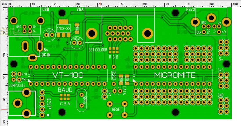

OK, here is the revised board.
NO SMD. All parts are thru-hole. Being that there are no SMD, that means there is no RTC chip.
I did add footprints for T-block or header power input(0.2" and 0.1" respectively) over the top of the DC socket, so you can choose one of three different connectors to fit for the power input - along with power via USB also.
