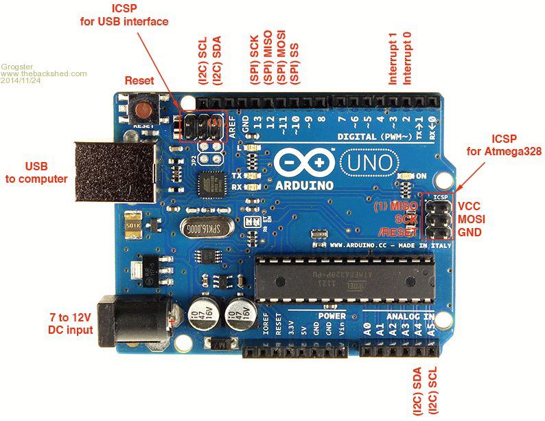

This is the first pinout I found:
...and these are the dimensions I have found:
Edited by Grogster 2014-11-25

Grogster,
Those sizes CANNOT be correct.. the difference between the 62.5 and 48.8 is 13.7mm which is 0.54" given the RH connector is 0.7" long it cannot be.. I have the dimensions around somewhere I will try to dig them out for you.

Grogster,
Here are the correct dimensions for the Arduino connector.. Note that there is also an `incorrect' version that has the RHS gap as 0.15".. Whilst this is not quite the original spec they are close enough that they will work.. If you were going to do an Arduino style board I would use the correct 0.16" gap.
Also beware, as whilst it sounds a great idea, it has been done with the Duinomite range and Colour Maximite and the DonDuino Cross PCB and I really do not think that the Arduino footprint with any of these were popular and that very few were actually used with Arduino shields installed..
It wasn't seen as all that useful, for some reason or another. I, personally, do not agree with that but that is how the market saw it.
Many criticisms were because of the speed of basic.. That `may' now be different with CFunctions but think carefully.
Also the Arduino footprint is not all that user friendly IMHO it could be better to create your own bus and build add-on boards for it..
Anyway good luck PCBster
EDIT **
I see the distance between the rows is also different in your picture They have it as 50.5-2.54 or 47.96mm whereas it should be 1.9" or 48.26mm
Edited by bigmik 2014-11-25
