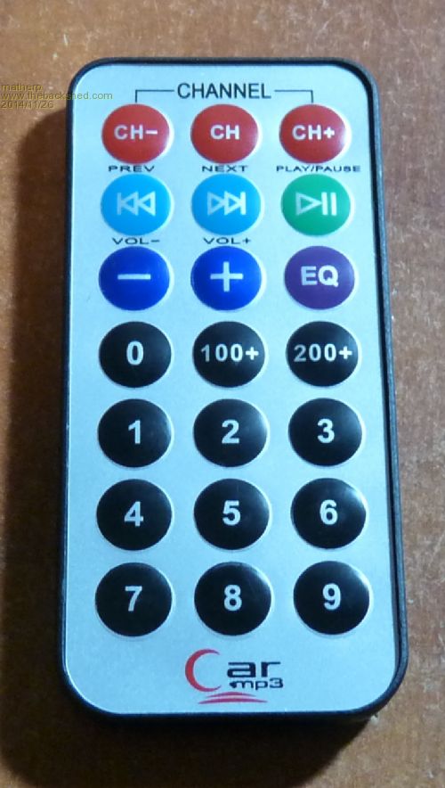

I don't think there is anything you can't do with a Micromite MK2
The very cheap IR remote controls available on ebay such as item 281489966317 (£0.99)
transmit using the NEC standard code which of course is completely incompatible with the Sony code that Geoff has included in the Micromite firmware.
However with a little bit of C it has proved easy to reliably receive the NEC code in a non-blocking interrupt routine.
The program uses pin 2 on the Micromite. It could be any pin with interrupt capability but the cFunction would need some changes.
The NEC standard starts with a 9ms pulse. This gives plenty of time for a negative edge triggered interrupt to call the IRreceive cFunction. The cFunction then starts hardware timer 5 and uses this to time all subsequent positive and negative pulses up to a maximum of 66 (32 bits, 2 edges on each, + 2 edges for an initial 4.5msec low period). There is a timeout built into the code in case of an invalid pulse train and to establish the end of the pulse sequence. Once the complete set of pulses is received the cFunction uses the measured length of the 4.5msec pulse to establish a cutoff period between "1" and "0" pulses. This makes the code independent of processor speed.
The cFunction then packs the data received into the 32-bit function return.
A return of &HFFFFFFFF means that a repeat pulse the same as the last one has been received. A return of 0 means an invalid sequence and should be ignored. Otherwise there will be a 32 bit number representing each key on the handset.
For the handset referenced above they are:

Posts: 11914
Posted: 01:23am 27 Nov 2014
Please find attached an update.
I've changed the timer to timer-1 as per Geoff's suggestion.
I've fixed a bug in the repeat function.
Also I've found more about the NEC code. It sends 32 bits, The first 8 are the address, the second 8 are a ones-complement version of the address, the third 8 are the data, and the fourth 8 are a ones-complement version of the data. This means that the packet always has 32 ones and 32 noughts in it and is always the same length.
It also allows the data to be checked between the normal and inverse version.
The cFunction now makes the check and returns the address * 256 + data (or 0 if the check fails). As the address for these cheap remotes is zero that means we now just get a single byte representing the button pushed.
