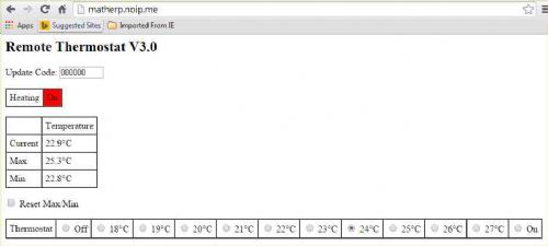

Another port from Picaxe but something completely different this time, no cFunctions or complex peripherals just ordinary Basic logic.
This is one of a range of web controlled applications I had built to allow remote control of a friend's holiday home.
Try it live on matherp.noip.me, the update code for resetting the max/min or changing the thermostat setting is 123456
The "starttemp" constant defines the range of thermostat values displayed. "Hysteresis" defines how sensitive the output is. A setpoint of 24 and hysteresis of 2 says that the heater will switch off at 24.2 degrees and on at 23.8
I use the TLN13UA06 wifi uart as the web interface (look for "2.4G Wireless Serial Wifi Module Embedded Uart-Wifi Module" on Aliexpress) but it should work on any wired or wifi uart that supports TCPIP server mode. The code does not include set up of the wifi access parameters as I set these up separately and these will vary between different types of modules.
The important module is get gethtmldata$. This parses the html request from the browser, gets rid of all the spurious junk, and returns the web page required and the number of arguments - if any. The arguments themselves are stored in the arg$ array. It has a timeout parameter as an input. This allows control to return to the main program for processing data, in the case of this example reading the temperature and controlling a heater whilst also waiting for user input.
The main loop processes the results of gethtmldata$ and acts as required. The main loop should be implemented as a "SELECT CASE" but I'm having a problem with this. I've reported the problem to Geoff but it is probably me doing something stupid.
The html text is stored as multiple CONST strings. All variable data to be output is done using STR$ with a fixed length. This allows me to pre-calculate the length of the web page and include this in the page header (Content-Length:nnnn). I do this because some of the cheap IP uarts do not support a timeout to trigger the browser to write the screen. Setting an exact length means the browser knows when to display. It is critical for this calculation that all "print #" statements are terminated with ";" so that extra cr lf characters are not sent.
The code does not use any EXIT statements. I really dislike these and they are the most likely area to find firmware bugs or just limitations on use.
The basic framework of this code is infinitely multi-purpose for simple interactive web sites. The slog work is then creating the html and whatever program logic is required for the application.
Obviously there are an infinite ways of skinning this particular cat but I find this way quick and flexible.
Hope this is useful

Kind words, thanks -pity there is a bug in the code
The statement:
setpoint=asc("E")
in the INIT: section should appear before the "VAR RESTORE" statement so that if there is a saved setpoint it is used after a power up or reset.
Sorry!
