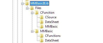

Is this the kind of thing people have in mind (maybe hosted on TBS if possible)
MMBasicII Library
see OLEDI2CLib.bas for an example of a wee bit of 'Editorship" having been applied to minimise name-space clashes for Global Variables, and a slight moving around of the code so that the TestSuite code lines are placed at the end of the program for easy deletion. (would this kind of editorship be acceptable to Library contributors ?)
Peter
The only Konstant is Change
Posted: 07:15pm 07 Dec 2014
Peter that's nice and neat, no fancy graphics or large files. Spot on.
The format is good because its easy to search, and easy to stick into a database at a later date. Once in a database, you can add a few nice features like order by column, better search, etc.
Might have to format the file names so less chance of getting duplicates, like SerialTxt_1_0.bas for the version 1.0 file
I would be OK to host something like that. I've recently found out my monthly bandwidth for the web site has gone up. It was only 30Gig originally which was often exceeded, but now its like 10 times that so I'm not as worried about exceeding my monthly limits.

I can see this needing some "categories" at some point, but exactly what I envisioned as well.

Hi Glenn
Thanks for the positive feedback.
Before you responded, I was thinking about a page-per-item approach - like man pages on Unix, where the index.html page simply had short links to the page for each item, so that the page could contain a lot more information. However that would of course increase storage size, and make database'ing the pages a bit more complicated, and materially increase the workload for the Editor/Librarian/Curator.
Being able to search and order by column would be really nice especially as the number of items grows.
Let's see what others think.
Peter

Posted: 09:59pm 07 Dec 2014
If you wanted to build the library in plain clean html, I can throw it in a iframe or use a bit of AJAX to display it within a TBS page. The TBS page "frame" would have the usual, like a menu and link back to main page, plus a couple of adverts but not in the middle area where the library content will be displayed.
Use tables, keep all links relative, and have a couple of sub folders, like "CFiles", "BASFiles", "PDF", etc. That will keep it transportable. Also ideally use a style sheet to keep the fonts consistent.
If the html is clean, its not to hard to import it at a later date into a database.
Or, if someone has MS Access and could use that to create the library in a table, then it would be easy for me to display that online. Displaying a access table is easy, its writing a web based administration back end that would take a bit of time to develop.
A Access database would mean we could jump straight into adding column sorts, filters, etc. The "librarian" would just need to email the updated table to me plus any new files.
Another option is to create the table in Excel, but a little more work to get set up right and longer to get a update online.
G8JCF
Joined: 15/05/2014
Posts: 676
Posted: 10:57pm 07 Dec 2014
Hi Glenn
The library code is all simple HTML and positioning is by tables, and indeed the data is held in folders/subfolders
As for the Database options, I could do an Excel file, but that's about as far as I could go - it's been too many years since I did dB work (30).
Peter
