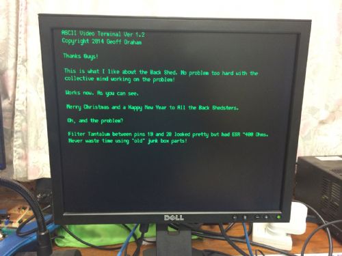

Alright, at the risk of partially answering my own question we have made some progress.
The ICSP pins used between MX150 and MX250 appear to be different. Using information found here (Google):

1. Make sure that the VGA monitor is properly plugged in when you power on the board otherwise the firmware will generate composite output.
2. Jumper the serial Tx and Rx pins so that anything that you type on the keyboard will be echoed to the video output.
3. If you have an oscilloscope check that you have the correct signals on the VGA connector.
Geoff

Yes I think your right. After my "successful flash" above I can see the external 8Mhz clock signal with the scope. So something happened.
  Geoffg said   1. Make sure that the VGA monitor is properly plugged in when you power on the board otherwise the firmware will generate composite output.
Done. Two different monitors. No video out. Monitors can "see" that I have connected to a device (they stop complaining about the VGA cable being unplugged) but fail to sync or see any video signal. They go into power-save mode shortly thereafter.
  Geoffg said  2. Jumper the serial Tx and Rx pins so that anything that you type on the keyboard will be echoed to the video output.
Installed jumper between RX and TX pins on serial port. No echo. Blank screen. Are CAPS-LOCK and NUM-LOCK supposed to come on and toggle On/Off? Because I'm not seeing that either.

OK, I just tested a MX150 in the original prototype, programmed it with Terminal_V1.0_plus_Bootloader.hex from the Construction Pack and it worked perfectly (without USB). So, you don't need to be worried about Vusb3v3.
Yes. Do you get the LED illuminated on the Terminal PCB? If yes, the firmware is running OK, if not there is something stopping the microcontroller from running.

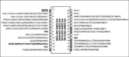

You sound confused about pins. Have a look at the image or look in the zip for a bigger picture. It is from the Microchip datasheet.
2014-12-26_100904_PIC32150F128B.zip

The confusion is that the ASCII terminal board connects ICSP data and clock to pins 2 & 3 (perhaps not in that order). While Mick's uMite has them connected to pins 4 & 5. And I'm being told that the ICSP clock and data are the same for both chips.
But last time I checked 2 != 4 and 3 != 5
So there is something here I don't understand.

The pinouts for the 150F and the 250F are different.
The 250F has the following
PGED1=4
PGEC1=5
PGED2=21
PGEC2=22
PGED3=2
PGEC3=3
The 150F has the following
PGED1=4
PGEC1=5
PGED2=21
PGEC2=22

Posts: 2556
Posted: 01:34am 26 Dec 2014
bob just beat me to it. while an MX150 will work in the terminal PCB, the ICSP connector on the PCB runs to the wrong pins, so you can not upload firmware to the device. in all other regards (apart from USB) it works.
it is allowable to use any of the three pairs of ICSP pins (PGCx and PGDx), but they must be used in pairs. ie, using PGC1 and PGD2 together will not work. your easiest bet is to make up a ZIF socket on a scrap of veroboard containing the ICSP socket (wired as per micromite) and the 10uF capacitor, and use that for programming devices. pairs 1 and 2 are on the same pins on both MX150/170 and MX250/270 devices. this is what i do.

Thanks Bob,
That sums it up succinctly I think. I've been reading:-
http://ww1.microchip.com/downloads/en/DeviceDoc/61129F.pdf
And from what I read it does not matter which PGEx pair you use. So long as you use a matched pair. The ASCII Terminal PCB connects the ICSP clock and data to the PGE3 pair on pins 2 & 3 of a 250F. Which is fine accept when you try and substitute a 150F which has no PGEx pair at all on pins 2 & 3.
I'll mod the PCB to move the ICSP data & clock permanently to pins 4 & 5 -> PGE1. Which should work for both 250F and 150F and also solve the problem of needing to remove the baud rate jumpers prior to programming.

The fact that LED1 does not illuminate is a sure indicator that the PIC32 CPU cannot start. Things to check:
- The 10uF on pin 20 must be a high quality tantalum. Is the polarity correct? Try replacing it with a 47uF.
- Check that 3.3V is on pins 23, 26 and 13. Check that ground is on pins 27, 8 and 19.
With just the 10uF cap + power a correctly programmed chip should pull pin 14 low, which turns on the LED indicating that the firmware is running. No other connections are required.
Geoff

Eureka! As they say.
Big thanks to:-
JohnS, for writing the Raspberry Pi ICSP programming software. Works a treat and I can assure everyone that it is FAST! In my case especially important because I had no other programmer available.
Bigmik, for thoughtfully providing an updated v1.2 firmware image that contains both the Bootloader and Program. Mind you when the MX250F arrives I'll still have to flash it with the Rpi because I have no USB with the MX150F. But at least I have the latest Firmware.
BobD, and all the others who replied. For giving me a quick run-down on 23 bit PIC ICSP programming and pinouts.
And Finally to Geoff, who was able to pin-point the problem to the 10uF Tantalum on pin 20.
And the problem? My 10uF Tantalum capacitor shows an ESR of about 0.5K Ohms in my component tester. Whereas a garden variety 10uF electrolytic was reading about 0.2K Ohms in the same device. So I replaced it with a 1uF (all I had on hand) Tantalum that had ESR so low the tester couldn't even see it (i.e. less than 1 Ohm). As soon as I did this it burst into life.
Wishing everyone a Happy and *Safe* New Year!
