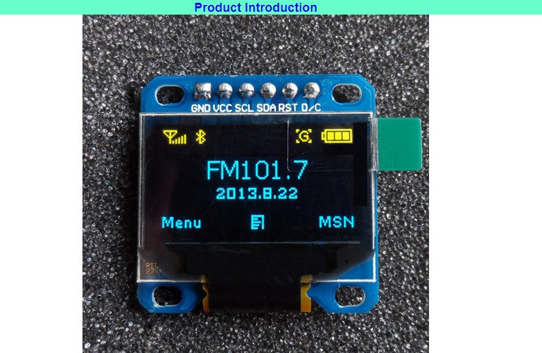

Hi all,
I bought a OLED on Ebay. It looks very similar to this one and has the same pin-description:
My question is now:
Is it configured als SPI or IIC???? It has no soldering Jumpers on the other side and I can't find any information about the configuration...
It should be possible to use this OLED as SPI OR IIC device but what must I do???
(I would prefer SPI...)
Thanks for any help!!!
Frank

i mean its I2c. dont forget the resistors ,load the forum code this need 2-3 minutes and you know it .

thanks for your answer - but what shall I do with RST and D/C??? Shall I leave it open?
Frank

maybe this help ,
http://smart-prototyping.com/OLED-0.96inch-12864-display-mod ule-blue.html
looks like it support spi and i2c , dc switch the mode (?) and reset is reset .
i dunno really but beware the 5v using , my device uses only 3,3 v and works fine with i2c

Can you post a picture of the other side of the display?
Try it with my I2C code in this thread. It won't do any harm and may work - let me know.
I suspect it will default to SPI but there needs to be a CS connection as well. Looking at pictures of various versions on ebay it looks like there may be an option to permanently connect CS. Given a picture I may be able to help

I think that D/C is only used for SPI.
Most of the modules can be configured for either I2C or SPI. Can you rty the SPI code?

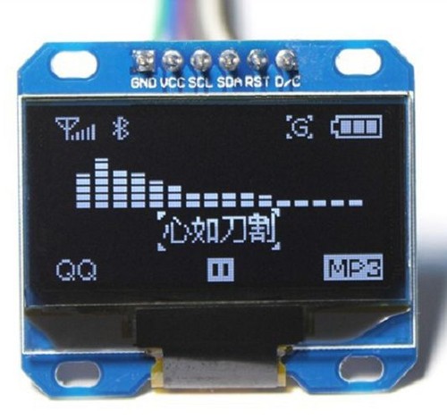

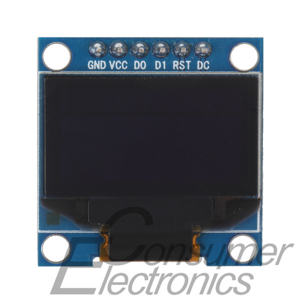

It's alive!!! [
I connected it as SPI and tried Matherps SPI version!
I bought it as a blue OLED display but it is a yellow/blue one like this one:
The backside looks exactly like here:
In the description of this display stand that this is a SPI device (I bought mine as I2C AND SPI...) but I am happy that it works!!!
Many thanks to Matherp for his work and all the others for helping!!!
