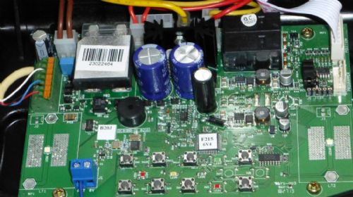

Posted: 06:34pm 10 Jan 2015
  Gordz said   Hey Bob, what about tapping one of the encoder outputs to create a simple counter. Monitor the motor wires for direction (up or down) the home switch and there you have it. 4 I/O pins for the lot ?
This is the door controller. It is mounted in a tight spot with about 300mm to the wall but I may be able to get the orange cover off it and find the encoder.
Here is a photo of the board. You can clearly see the ribbon cable in the top right tagged POSITION and my efforts on the left with the 2 pair in the terminal block. I can get a stop / start from that block with the red and black wires.
On the right, the header below the ribbon cable is marked PROGRAMMER. There is 5 pin socket to the left of that marked ICSF.
I probably can't do much more than look at it because to do else may void the 4.5 years of remaining warranty.
I have a lot of great advice and I'm going to sit back and see what approach to take. That is something like what WW suggested or what Mick has suggested. I like the ideas of Gordz but I am probably not going to be able to do much in that direction.
Posts: 2981
Posted: 06:47pm 10 Jan 2015
Bob,
If you want to get at the header cable without causing any damage make yourself a male-female. `breakout cable' that way you can then attach test wires to and see if you can sense any position pulses.
That way you dont need to patch into the ribbon itself (thus voiding warranty).

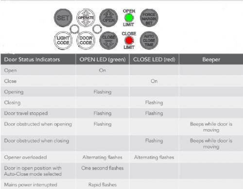

OK, I've thought about what to do and getting into the door controller is probably not the way. It's in a too difficult position with very limited physical access.
The door controller has two door status LEDs on it and they do a great job of reporting where the door is and what's happening. See the diagram. I thought I could mount a couple of optical sensors over the top of these indicators and report the info to a Micromite. Then use the Micromite to report by wireless to another nearby Micromite which would duplicate the status indicators.
Here is where I need help. Recommendations for optical sensors and a wireless device.
Posts: 2991
Posted: 02:28pm 10 Feb 2015
Hey Bob, good to see you're still working on this!
To detect the LEDs you could use a single RGB light sensor such as this one. It outputs I2C so easy to interface to a MicroMite.
Regarding RF, I would personally use the Hope RFM12b module. Nice and cheap, good indoor range, low power, and again are easy to control with a MicroMite (once they have been configured properly that is!!).
These are just to give you some feedback - I'm sure others will give their ideas too.

Posted: 02:39pm 10 Feb 2015
Phil
Thanks for the advice. The optical board looks too big to fit the available space and I would need two of them. The ideal would be a device the size of a 5mm LED. I could mount two of them quite easily.
The RF solution looks good.
