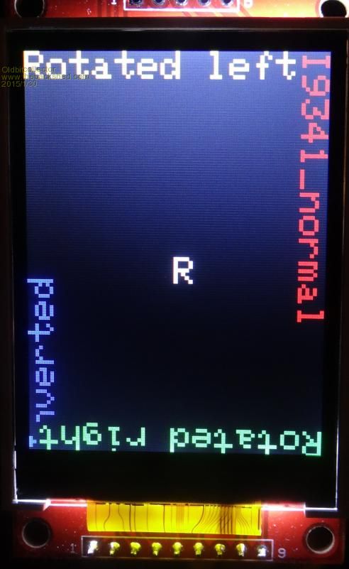

240x320 TFT ST7781 controller - parallel I/F (many 2.4" Arduino shield displays)
240x320 TFT ILI9341 controller - parallel I/F (other 2.4" and many 2.8" Arduino shield displays)
240x320 TFT ILI9341 controller + XPT 2046 touch controller - SPI (2.4" displays)

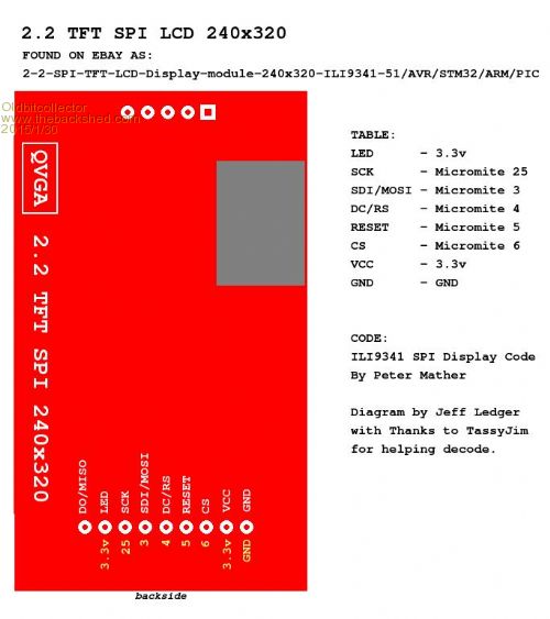

2015-01-18_190412_Graphics-v1.2.zip

Just found this listing 1.8" TFT
- 3 options for controller and all slightly different but all use the same x,y,positioning commands so we now have 7 possibilities for the 1.8" controller.
ST7735B
ST7735R
ILI9341
SPFD5408A
SPFD5408B
HX8353
S6D02A1
The good news is that the same cFunctions should work for them all so it will only be the Basic code that needs changing.
The bad news is that the only way to tell which you have is to find initialisation code for each and keep trying until it works properly.
In all cases, using my SPI routines, intialisation consists of making a call to set the register you want to update and then writing a number of databytes as required by the register.
The best sources I've found of "working" initialisation codes are usually Adafruit or Itead or Sainsmart if they have ever used the particular controller.
I guess the moral of this story is only to buy off vendors who are absolutely specific which controller is used and who list appropriate sample code - doesn't matter if it is Arduino, it is just important that there is working code available.
Edited by matherp 2015-01-24

Reporting another success... (thanks to TassyJim for helping me decode it a bit)
I took a chance on the 2.2 SPI TFT LCD-240x320-ILI9341
After seeing it work perfectly here, I took a few minutes to create a simple diagram to help others. See attached

Thanks TassyJim..!!
Looks like the 10 1.8" displays I got were the S6D02A1 type controllers, got the 1st one up and working... Big thanks to you and Matherp for doing the hard work..!
