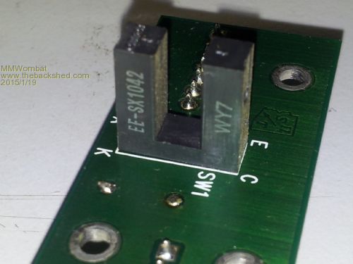

Oops, seems I was incorrect in my evaluation of the sensor. The reason I could not see any markings was because of the soot from the fire. I noticed on a piece of the machine, that was not installed at the time, namely the rotary tool, there was one of the sensors.
It is an EE-SX1042 from Omron.
DataSheet : Info
My understanding of the data sheet : Note 2, is that it requires a pulse.
Would this be suited to a MM II to drive the sensor circuit for the cnc driver?
How would I set it up? At the moment I can live with soft limits, set in the software, but a hardware backup, would be double safe..
If it is a PhotoMicroSensor, would the soot have damaged it, and would require replacing?
There are three the same size, Z table limit ( Top and Bottom ), and Y Zero limit, and 1 tiny one for the X Max Limit.
The machines inside (ambient to the sensor) would have to be around 80-100 Celsius to stop the ABS plastic printed part from warping. Would that mean I should look into a different sensor?

By the silkscreen on the board they are photo diode type the A K are a led the E and C are the emitter and collector of a transitor.
There probably is a resistor in series with the A or the K on the board. The E is probably connected to gnd and the C to something else via a resistor.
Hope this is of use.
Cliff
The data sheet shows how to connect the device.Edited by centrex 2015-01-20

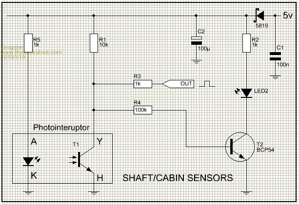

I agree with Centrex. I have used heaps of these kind of photo-detector, and they are very easy to use and incorporate into a circuit - most of the time.
Here is a circuit I built using one of these type of thing:
In "Normal" operation, the IR LED in the photo-interrupter is lit, and this causes the transistor in the photo-interrupter to switch on, pulling the output low. This also pulls the base of T2 low, keeping LED2 off. Whenever something interrupts the IR beam, the transistor will switch off, and the output to the MCU will go high. T2 is only there as an inverter/buffer for the LED to show when the beam has been broken, but it is not needed, strictly speaking.
EDIT: To clarify - transistor T2 and LED2 are not really needed - I just put them on the circuit for the hell of it at the time, and you don't need R4, T2, LED2 and R2 unless you want the red LED to light whenever something gets in the path of the photo-interrupter.Edited by Grogster 2015-01-20

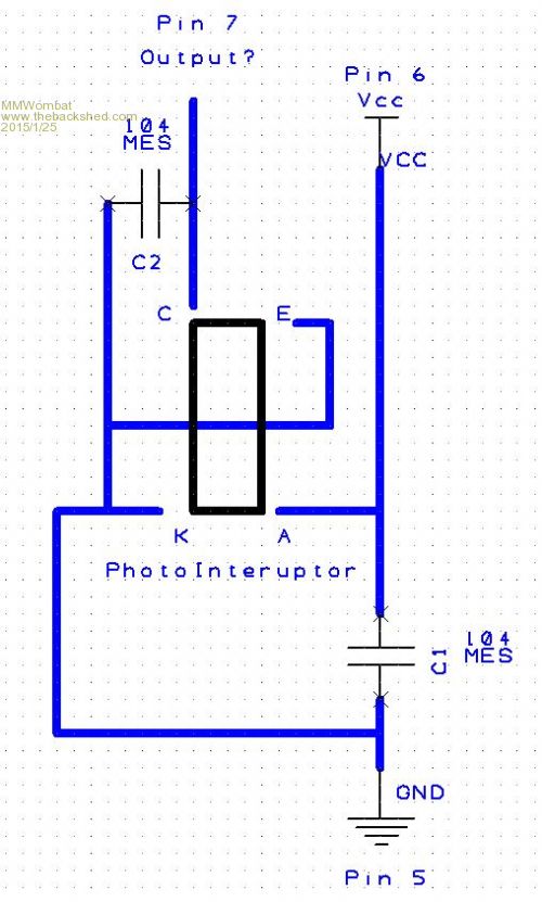

Here is a small schematic that I took from the PCB.
If I wanted to use this in the 3D printer, as a limit switch, would I join the output (pin 7) to the servo driver board(HY-TB5DV-M_5Axis_Driver), as active low or active high?
Is it a constant voltage or pulse?
What COULD the VCC be?
Thanks in advance

I am surprised that there is no limiting resistor in the diode side.
I would start with 1K to 5V as in Grogster's circuit and measure the current - aim for 20-30mA.
On the photo transistor side, a 10k to 5V or 3.3V (same as Grogster's again).
The output should be low when there is nothing in the light path and high when interrupted.
Which way around that is depends on the physical setup of your machine.
If you can get it to PLAY the guitar, I would be really impressed.

I concur with Jim - odd that there does not seem to be any LED limiting resistor.
I guess it could(must?) be on the mainboard.
"Pin 7 Output?" - I expect not. Unless you are making pin 7 on the MM, and INPUT.
Generally speaking, photo-interrupters like this, are USUALLY all connected as an input device - I have never seen one as an output device.
The concept is that you are using the interrupter to signal to the MCU, that the IR beam from the LED has been broken by something physical getting in the way. You are not actually switching the current to any motor or servo etc with the interrupter. It is then up to the MCU and code to decide how to handle that event.
EDIT:
  Quote  If I wanted to use this in the 3D printer, as a limit switch, would I join the output (pin 7) to the servo driver board(HY-TB5DV-M_5Axis_Driver), as active low or active high?
It depends on how you wire the circuit. The transistor in the photo-interrupter will switch on through the C-E path, when the IR light from the LED hits it, and it will switch off when there is an obstruction in the IR beam. In my circuit above, the input to the MCU is normally low - being pulled low by the photo tranisistor in the interrupter. If something interrupts the IR beam, the photo transistor switches OFF, and the 10k/1k resistors pull the MCU input to 5v or so - the MCU input goes high whenever the IR beam in the interrupter is broken.
  Quote  Is it a constant voltage or pulse?
The output of pin7 on your module will be constant.
No interruptions to the IR beam: photo transistor conducts via C-E path.
Interrupted IR beam: photo transistor does not conduct via C-E path.
The safest method is to use the interrupter to signal the MCU, which then controls the servo driver.
Edited by Grogster 2015-01-26

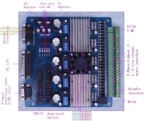

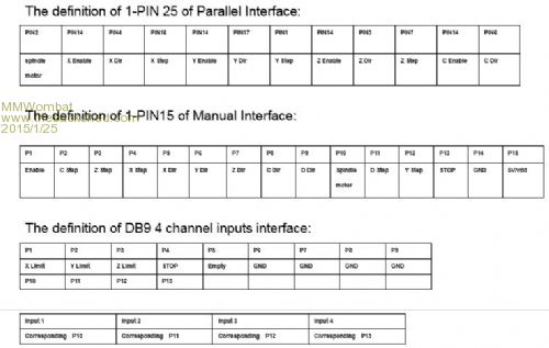

The Pins are from the small circuit board, that controls the rotary unit.
It has 7 pins. the first four are for the servo motor, and the last three, are for sensing the start point for the rotation.
I do not plan on using this unit, but similar photointeruptors are used for the X, Y and Z limits in the machine. I haven't checked on the Z limit ones yet, but the X and Y have resistors on the board, just can't see values for soot..
Here are some pictures from the Driver board DOC file. I can put up a link to it if needed.
Firstly the driver board.
and the pinouts for the D-Subs.
I would assume, I would take the 5V Vdd and ground from the 15 pin D-Sub, and join the wire from the 'C' side of the Photointeruptor to the corresponding input on the 9 pin D-Sub. Then set the control to 'Active High'.
OR Easier
just use some micro-switches as the limit switches.. on the 9 pin D-Sub
Connecting each pair (P1 and P6, P2 to P7 etc) through the micro-switches (Normally Open) for each axis. Upper and lower limits in parallel.
