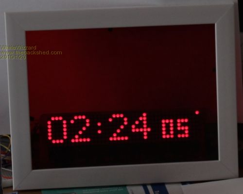

Posts: 2998
Posted: 04:34am 20 Jan 2015
For anyone interested, here is one of my LED Matrix clocks part built:
To give an idea of size, the frame is 24cm x 18cm. The electronics currently make it 5cm deep BUT I haven't made them SMD yet (a future intention).
This unit currently only has one line of text but another is going to be added to show date and/or Temperature.
The unit is controlled via an Apple Remote (to set alarm; and to set display options such as 12/24hr).
I haven't produced a PCB for this yet but if there is interest here then I may get a batch designed and made with SMDs to minimise thickness (for wall hanging) . . . .

Posted: 04:55pm 21 Jan 2015
Hey WW, this is very cool. I remember you mentioning this project back when you posted the apple remote code, which by the way is awesome!!!! I would love to see how you controlled the 8x8 matrix using the uMite. Did you use any Cfunction stuff or pure MMbasic?
Posts: 2998
Posted: 12:23am 23 Jan 2015
Hi Jim,
Sorry for the delayed reply.
The clock still uses pure MMBasic (as I still haven't got my head round CFunctions).
Each 8x8 matrix has its chip select connected to a MicroMite output, and I drive the data in using SPI at 3MHz.
After doing all the calculations for the display content, a routine basically draws 40 columns of data bytes (5 matrix displays x 8 LEDs = 40 pixels wide) looking up the required byte value from a font array.
It is rather 'messy' code which is why I haven't released it yet on this forum!! BUT it works very well!!
Bottom line is the display is bright, flicker-free and overall cost is reasonable. Note however, that it can't run from batteries
When I get a spare bit of time I will do a SMD PCB and offer it as a 'kit' on MicroMite.org.
Any more details then please do get in touch . . .
