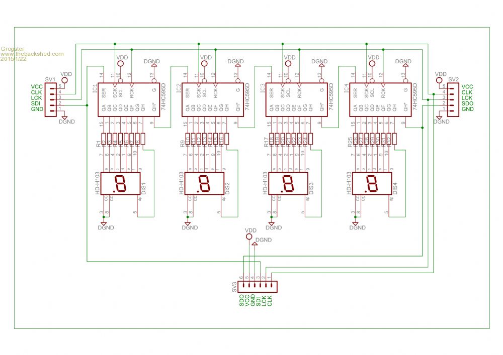

Here is the circuit for the display, stolen from an image on the link above:
From what I can see, all 595's are daisy-chained together(you are right!), so to show any four digits, I need to clock 32 bits to the display, then clock the RCK line, which should pass that data through to the segments, lighting up what is needed.
While clocking the 32-bit data to the display, I get the impression that the display will not change, until you clock the RCK line. Each time you do that, whatever bits are loaded into the registers will be reflected in the output - in this case, LED segments.

Do you have any bright ideas as to how I would build the 32-bit word to send to the display, representing the four digits I need?
Lets start with something simple like "1234"
Assuming the data from the Arduio code is right, then the 8-bit data for the numbers would be: "1"=&H60, "2"=&HDA, "3"=&HF2 and "4"=&H66.
How do I combine those bytes in the correct way, to generate the 32-bit word to send?

  Quote  o you have any bright ideas as to how I would build the 32-bit word to send to the display, representing the four digits I need?
dim integer a=&H12
dim integer b=&H34
dim integer c=&H56
dim integer d=&H78
dim integer s=(a<<24)+(b<<16)+(c<<8)+d

You, on the other hand, seem to be rather good with the numbers.
