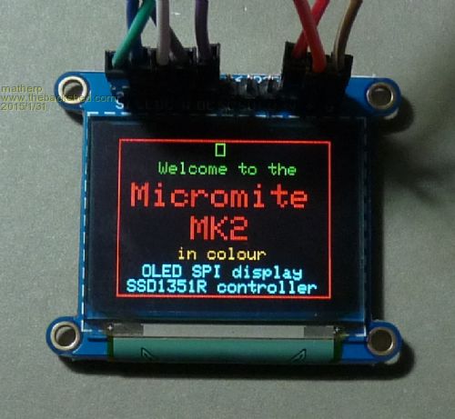

Another by request - this time from WhiteWizzard
This a nice little colour display, runs on SPI, but OLED rather than TFT. It is available in 128x96 and 128x128 versions but there aren't yet pre-packaged ones available very cheap - this one is an Adafruit one purchased from Maplin in the UK.
It needed slightly different Cfunctions from the TFT displays but not too hard to port.
Because it is relatively low resolution it refreshes very fast even over SPI.
2015-01-31_183725_SSD1351ser.zip
The Basic demo/test program and the Cfunction c-source file are included in the ZIP
WW, please note the position of the connection wires. There are two command/data pins (one for the onboard SD card) and it isn't obvious which is which.
The connection to the 3VO pin isn't needed (3rd from right). This is actually an output from the onboard regulator, just connect 3.3V to Vin.Edited by matherp 2015-02-01

You don't need the 64-pin for this small display - it runs plenty fast on the normal Mk2. It isn't the easiest display to build a board for as it needs 12V generating to drive the OLED. The Adafruit Board has a charge pump circuit to get 12V from 3.3
Peter

I have a few of the EastRising 1.5" OLEDs (128x128 pixels). I was going to send one to matherp to get his code working with it. However, rather than debug hardware and/or software for these units (i.e. I would have to build an interface unit) we decided to buy a pre-built module with the same controller chip.
The adafruit unit I ended up sending Peter is a 128x96 OLED bought from Maplins here in the UK.
I will be trying the code on the adafruit module later (the one pictured in matherp's post) and then look to build an interface module for the EastRising 'raw' display. I will then see if Peter can modify his code to work in the faster Parallel mode (as opposed to SPI).
If you want me to send any OLEDs then PM me The adafruit is expensive at £28, the EastRising display is £8.80 (import tax )
