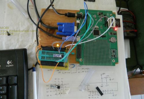

About 8 years ago, I wrote a VB6 programme to assemble 8 bit PIC code and write the hex file data to the pic. I have been tinkering on and off for a few weeks translating the VB6 to MM code. The idea being that the MM editor be used to write the assembly code to the on board SD card, then assemble it and dump the resulting HEX code to an 8 bit pic. So far, I can read a hex file into the MM and dump the programme, eeprom data and config byte to the desired pic (not 32bit pics).
The programme will handle up to 2048 words and 256 eeprom. So far, it has two programming modes, i.e sequential and 4 word block mode. Programming speed seems to be quite reasonable.
The current version uses LV programming but the HV mode software is built in. HV means including a 12v(ish) supply plus a 12v MM controlled switch for the reset/HV pin. This is needed if the config of the PIC has been set to HV mode otherwise. Most early programmers only worked with HV mode. I swapped from using mostly string functions for data manipulation to numeric arrays. The full hex file is dumped into arrays on the MM and sent from there to the PIC.
There are consequently a few routines that are not used but I've left them in checking out.
I don't know if anyone still uses 8 bit pics?
I'll clean up the code and post it in a day or two just to show the basic functions.
If there is any interest, I'll also translate the Atmel Programmer version.

Here is some code and a picture.
The .ASM file is the code to blink a led on pic16f88 pin RB0.
The hexfile.HEX file is the assembled pic 88 code and is currently hard coded but the code can be altered to allow user selection of different HEX files.
The file picprog8.bas is the MM programmer code.
The file "spare code" is leftover routines from conversion from strings to number arrays.
In the MM code, progmode can be "1" or "2". "1" is for say a 628 chip and "2" is for a block programmed pic such as a F88.
The pin connections can be seen from the .BAS code.
Menu item 1 puts the pic in LV programming mode and must be selected first.
Menu item 6 erases the PIC
Menu item 10 loads the hexfile to the arrays and extracts the config word.
Menu item 5 programmes the memory and eeprom and config.
Even if no one uses this, there should be some useful code blocks in it.
This code and programmer are only functional and can be "prettied" up to make it more user friendly.

x Run PicProg8
x 'Setup' option 7 (set parameters)
x 'Setup' option 8 to save data and option 9 to revert to main menu
x 'Menu' option 10 - load HEX file
x Apply power to the PIC
x 'Menu' option 5 will erase and programme the PIC
x 'Menu' option 4 will verify all programme and eeprom.
If you want to set a different config word to that in the HEX file, first set a and save config word of 3FFF
After having selected option 10 (load hex file), go back to the setup, alter the configword and save.
Programme as normally and then reselect setup option 7, change the config word, save and return to main menu.
Select option 1 (lv prog mode) then 9 which will write the new config word. This can be verified in option 8.
the results are shown in binary with address 2007 being config and 2006 being device ID.
Hope that isn't too confusing.
Now to get a simple PICASM8 assembler working.
2015-02-24_111117_picprog8.zip
David M.
