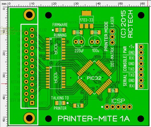

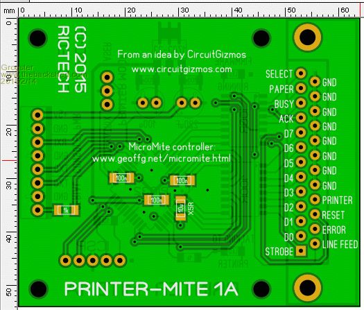

As an expansion on the code we talked about in the forums a while back, on printing to dot-matrix parallel-port printers, here is my latest PCB.
TOP COPPER:
BOTTOM COPPER:
The board will cater for pretty much any standard dot-matrix parallel-port printer, but I also have plans to support parallel-port laser printers as well, in a limited fashion.
Dot-matrix printers USUALLY print as soon as they receive a CR byte as the data is clocked into them, so control of these is USUALLY relatively straightforward. I say "Usually" here, as in my testing all dot-matrix printers have all printed the line, once you clock the CR byte into the printer at the end of the line, but not before. This is not to say that every dot-matrix printer will do it this way, but it seems like most of them do.
Printing to a parallel-port laser printer is a bit different, and seems to be based on buffering the data in the printer memory, till a FF(form-feed) command is issued, so laser printers won't print anything till you send a FF command, or the "Page" memory is full(at which point, the printer will automatically print the page by itself). This has been my experience thus far anyway, and makes sense for a laser printer when you think about it, as it HAS to print the whole page in one go no matter what - C'est La Vie. You can get a parallel-port laser printer to print each line one at a time, but you have to issue a FF after each line, and this means the laser printer will only print one line per page, which is not very practical, and very wasteful on paper.
With the new MicroMite 2 chip based on the 170 chip, we have plenty of memory in the chip to use to setup an array for buffering the printer data, and thus can buffer a full page of text for laser printers. Technically, you don't need to buffer the data in the MicroMite - the printer will do it for you, but buffering it in the MM in an array, means that you can change any of the data for the page(by changing the relevant array element or bytes), right up to the point when you ask the printer to print it out for you.
Both the dot-matrix and laser printing make use of the printer control lines for flow-control, meaning that you can clock the data to the printer quickly and not lose characters. Laser-printing page-at-a-time is much slower, as once you have a page of data in the MM array, you then have to clock it all out to the printer, and this does take some time. Specs say that you can clock 1000 characters(bytes) per second to the printer as a minimum speed, and many printers will easily support faster rates then this, but if we assume the minimum speed, then:
80 character lines x 120 lines per page for A4 paper = 9600 bytes per page.
9600 divided by 1000 characters per second = 9.6 seconds per page.
So, basically, roughly ten seconds to clock a full page of text to a laser printer. During that time, the serial buffer on MM will handle any incoming data so long as it is not too much at once, causing a buffer overflow.
Laser printers are quite different beasts to the very standardized dot-matrix printers, so the laser-printer option is something that may or may not work depending on printer, as I have only managed to test one laser printer at this stage.
Please note that this PCB and MM code will NEVER, EVER support ANY USB printer on the planet. This is simply because USB printers need systemic driver files, which we have no hope of being able to port to something like the 170 chip. Parallel-port laser printers can be made to co-operate in a limted fashion, although they are often much more expensive the a basic black-and-white USB laser printer - again - C'est La Vie......

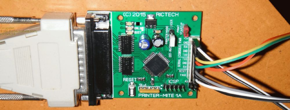

UPDATE: The boards have arrived, and I have got the first one running
There is a small censor block for the uppermost SMD LED - I meant to rename that "D'OH!" for as an error signal, but I kinda forgot to change the silkscreen before I sent the board off for production - whoops....
The current code only supports dot-matrix printers, but works fine, and I am working on the laser side of things - that requires buffering a page in the MM, and then clocking it out to the printer. A supported laser printer with a parallel port is needed to use this side of things.

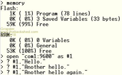

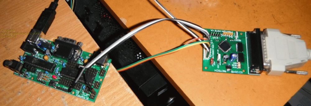

Here is a shot of it hooked to a VideoMite:
In this case, I have the VideoMite's COM1 connected to the PrinterMite's serial input, and you just send it strings and they are printed for you.
The PrinterMite stores message strings in the serial buffer, and can receive more messages while it is printing out the previous one, so long as the RXD buffer does not overflow. Thanks to the 170 MicroMite chip's extra memory, the standard serial buffer is 4096 bytes long, which is enough for up to 51 standard 80-character printer lines before the buffer overflows, and the module is always working to empty the buffer. 10K of RAM is also reserved in an array for the lines on a laser-printer page, but even with this memory gobbled up, there is still 30K or so of free memory.
Any string sent to the module is sucked out of the RXD buffer and passed to the printer, which allows you to send printer-specific control codes for special print modes etc.

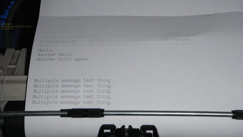

I forgot this evidence photo:
The multipule message test was just the VideoMite sending the same message five times in a for-next, and it was then up to the PrinterMite to decipher the messages and print them out, so this seems to be working at first glance.
