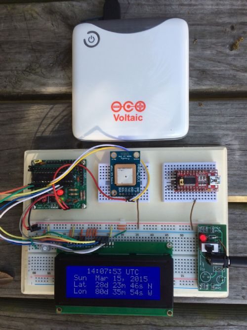

Here's a picture of a "portable" prototype using this GPS receiver.
This configuration uses Big Mick's MuP board (top left). The Micromite and LCD use 5 volts from a rechargeable battery. I'm using Ron Hackett's power supply board without the regulator (bottom right). The GPS (top center) and Micromite use 3.3 volts from the MuP on-board regulator. The component at the top right is a USB-to-TTL serial device used for programming the Micromite.
The 4-by-20 LCD displays UTC, day-of-the-week, and calendar date along with the latitude and longitude.
The software is basically the version posted earlier with output to the LCD.
