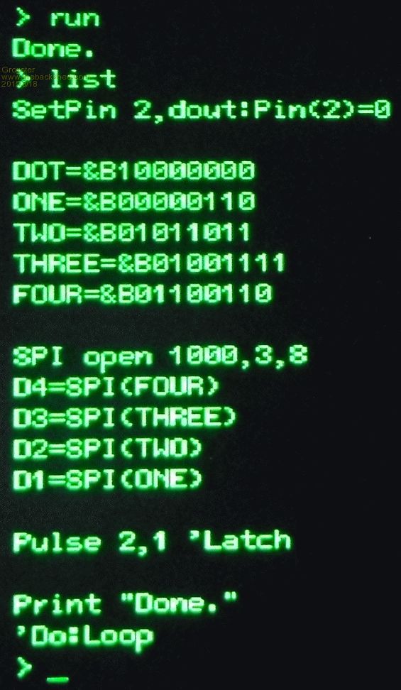

Posts: 10062
Posted: 01:39am 18 Mar 2015
PROGRESS!!!!!
Perserverence seems to be yeilding results.
Two mistakes I was making:
1) Forgot to connect the LED display GND to the Micromite GND, as I was using a different supply for the LED display due to it's current consumption
2) You need to leave the SPI port OPEN once you are finished. If you close the port, the display goes all "Flickery" - probably as SPI CLOSE returns the pins to a non-configured(read: high impedance) state.
Code that is working is:
SetPin 2,DOUT:Pin(2)=0
SPI OPEN 1000000,3,32
D=SPI(&B10000000100000001000000010000000)
Pulse 2,1 'Latch line
Do:Loop
This code lights all the decimal-point LED's.
Replacing with all zeros for the SPI command turns all the segments off.
This is how it should be.

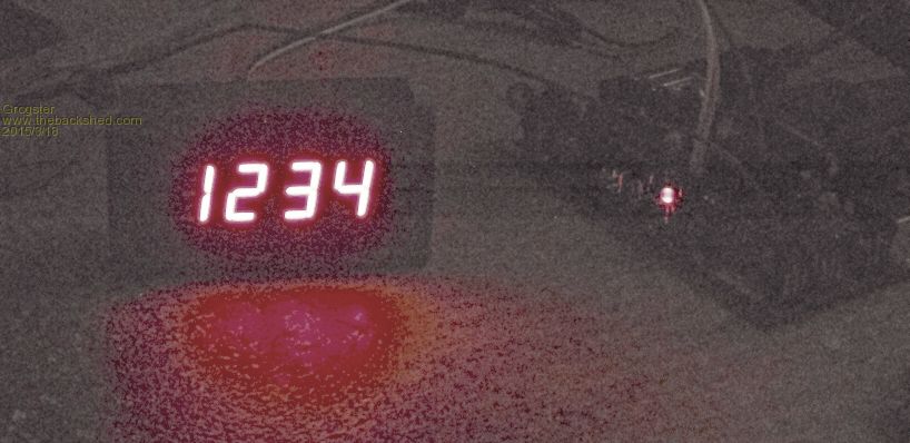

Posts: 10062
Posted: 10:06pm 18 Mar 2015
All up and running. Here is the sub that I wrote to take a standard textual input, convert that to numbers, and lookup a simple array to decode the bitmap for the segments etc.

This is working very well.
You can send a _ character if you want a blank digit.
You specify the location of the decimal point with a number from 1 to 4.
