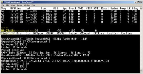

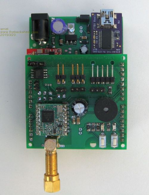

This is my prototype MicroMite II LoRa Receiver.
Its primary purpose is to act as the base for a LoRa wireless transceiver in combination with my Arduino style RFM98 shield. Together they will receive tracking information and sensor data from high altitude balloons that use a LoRa transmitter.
The concept was to make a portable transceiver with low power consumption that would be able to track, and collect and log data from, a high altitude balloon at long distances independent of an Internet connection.
The screen shot is of the receiver displaying the received telemetry from a tracker.

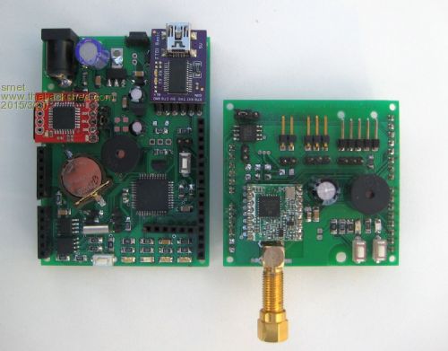

The prototype LoRa receiver base provides;
Connection for a FTDI USB serial adapter.
Connection for 3.5mm Stereo jack serial console (AXE027)
PCF8563 RTC and backup battery.
32Kbyte EEPROM
4 ‘traffic’ light LEDs.
Switch.
Reset Switch.
Buzzer.
DS18B20 temperature sensor, header for additional external sensor.
OpenLog Logger, for logging data and with optional jumper to allow for logging of console output for debug purposes.
12v or 5V supply input options, allows for single lithium battery operation.
