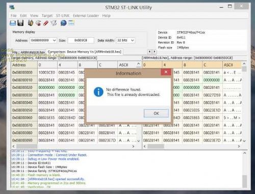

Attached is the latest beta release of the Micromite code for the STM32F407.
2015-03-20_083853_ARMmiteb18.zip
For details of how to get started with the ARMmite see this post.

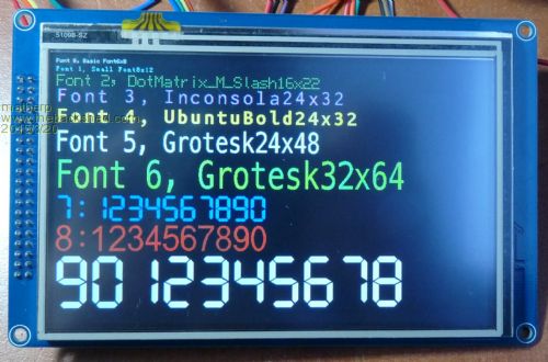

The other main change in this release is the implementation of in-built graphics routines. The following controllers are currently supported:

Once the display is open there are a range of drawing commands available:
DISPLAY font, xstart, ystart, foreground colour, background colour, textstring, (optional x-scale, or x and y if only this parameter specified),(Optional y-scale)
10 fonts are currently included as shown in the picture. The code includes wordwrap and protection against writing outside the screen area. All fonts can be scaled using the x-scale and y-scale parameters but note this does introduce a performance overhead.

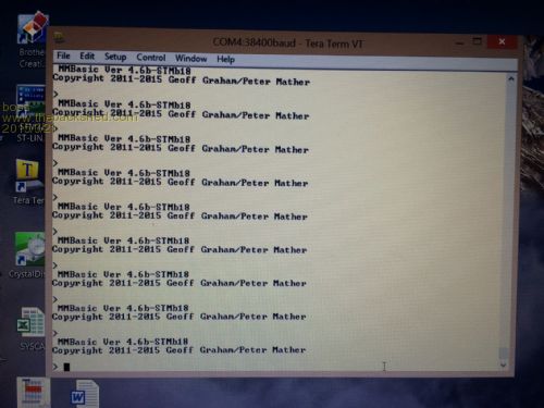

Hi Peter,
this release is awesome progress indeed.
Maybe I found the glitch - embedded EDITOR doesn't work for me although via MMedit I everything seems be O.K.

Boot x VDD connected, the chip was completely erased, then flashed and verified. The result is the same. Everything looks fine, even flash x file verification (see picture). No other problem was found yet, but embedded Editor.

Terraterm 4.86 and W 8.1 pro. It behaves madly. Greeting message prints 9 times, the reset button seems not working now. I'll install one more disk and try it again with fresh installed W7. What kind od Windows you have installed? Could virus infect hex file? I don't know. b12 seems working fine.

  Quote  Greeting message prints 9 times, the reset button seems not working now
That sounds like the reset pull-up resistor is missing/dry joint

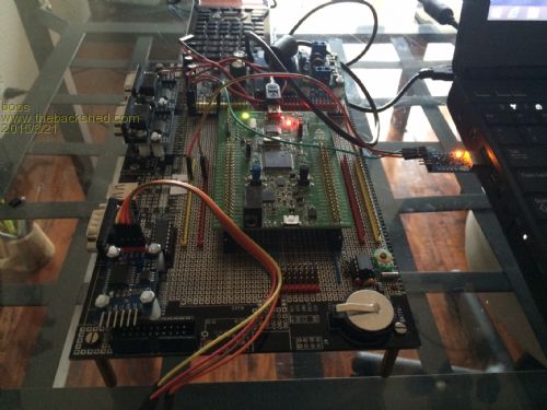

there are some picture, the Discovery board is firmly inserted in big prototype board, there could be absolutely no Discovery board damage
Hope that iPhone didn't flip picture upside down as happened last time
Will continue with W7
Bo

I can only suspect something about your proto board is shorting out the NRST and GND pins - this is definitely not a software issue

nope, tested NRST is working fine, fortunately I have another Discovery on its way. I plan to play with this mad one on W7 just determine what is wrong (HW or SW).

Can you unplug the Discovery from the protoboard? Then remove the shorting link SB11 on the bottom, also the two ST-LINK jumpers on the top. That will disconnect the st-link from the 407. Then just connect the RX, TX, and GND from the CP210x and the USB into CN1 to power it up. That eliminates all outside influences

I did as recommended and the result was the same then reconnect the jumpers back, erased, re-flashed and the result was same.
I believe it happened when I put jumper between boot0 x VDD fleshed then probably forgot remove this jumper.
