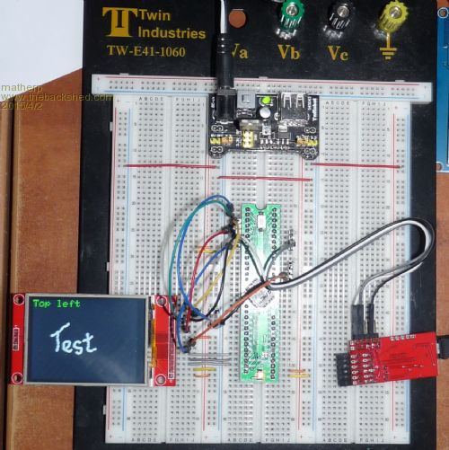

I've done some more development on the touch routines. Once the calibration has been run once the routines will now automatically compensate for all variations in which axis is which irrespective of which end of an axis the higher values are measured. The code also caters for and automatically compensates for any programmer-defined rotation of the screen
The developer must specify three key parameters as global constants
default_orientation must be set to 0 (portrait), or 2 (landscape), depending on the display used
screen_width is the pixel width of the screen in its default orientation
screen_height is the pixel height of the screen in its default orientation
The calibration routine must be run in the default orientation for the screen.
There are six key values which are returned by the calibration routine - T.calibrate:
The first thing it does is establish if the touch axis are the correct or whether X=Y and visa versa. Once it has tested and corrected for this it prints two values XSAMPLE0 and YSAMPLE0. These are output after the screen is touched for the first time together with the value for:
XLEFT0
Then by getting the user to touch the screen in 3 more locations it print values for:
XRIGHT0
YTOP0
YBOTTOM0
These are the values returned by the touch controller for the extreme positions on each of the two axis. It doesn't matter whether left is bigger than right or top is bigger than bottom, the code will compensate for this.
Once the six values have been measured for any particular screen they can be set as constants for future use and the calibration routine removed.
After hardware initialisation, the first call in the production code should then be to T.rotate(rotation).
This sets the screen itself to the desired rotation (0=portrait, 1=portrait inverted, 2=landscape, 3=landscape inverted) and initialises the internal copies of the initialisation constants( xsample, ysample, xleft, xright, ytop, ybottom, width, height) that are used in further processing. These copies will be modified at run-time by subsequent calls to T.rotate to compensate for any further changes in rotation.
There is just one simple user-function T.screenpos(x, y, timeout) that returns the actual screen coordinates as mapped by the current screen rotation. This means irrespective of screen rotation if you draw a box with particular coordinates, touching the screen within the box will return a x,y coordinate pair within the box - it can't get any easier
The timeout is specified in milli-seconds. The function will return a value of 0 if a timeout has occured without the screen being touched and 1 if a touch has occured.
I've attached two copies of the full test program including the calibration routine. One is configured for the ARMmite driving a SSD1963 800x480 screen (default orientation landscape) and one for the 64-pin MX470 driving a 240x320 ILI9341 SPI screen (default orientation portrait) - see the picture above featuring the mighty Skinnymite!
Both are tested as working in all 4 orientations after initial calibration.
The code in both cases is identical other than pin definitions, SPI channel usage, and the binary code for the shellsort Cfunction.

main:
if t.screenpos(x,y,1000) then
if x>3 and x<width-3 and y>3 and y<height-3 then circle x,y,3,&HFFFF,f
endif
goto main
