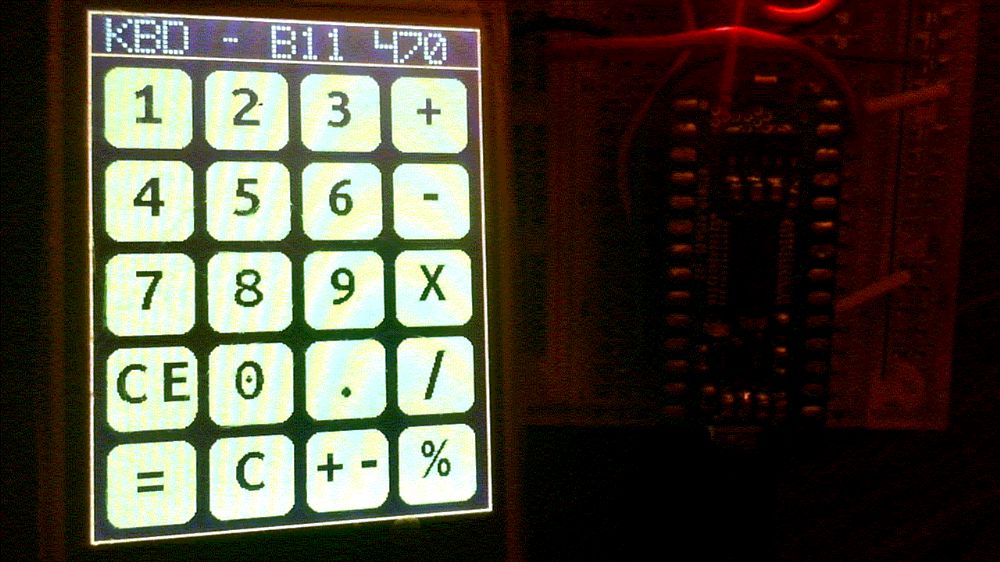

After some playtime on big G's skinny, I thought it might be a good time to start a thread to see how everyone is getting along with 470 testing and see any new toys or code snippets that could be shared...
I got the B11 code shot, and was testing out the new embedded graphics stuff...
So, let's get the ball rolling with this
It's not much yet, but by playing around with the front settings, you can create different size layouts
Dim integer ksize=49
Dim integer kspace=8
Dim integer kColor=green
Dim integer kRad=8
Dim integer toffX=12
Dim integer toffY=8
Dim integer tfont=4
Dim integer tFColor=black
Dim integer tBColor=green
Dim integer gutterX=10
Dim integer gutterY=35
2015-03-23_025946_2-4inch_LCD_KBD_B11_470.zip
If you have the SPI 2.4" touch display, give it a play...

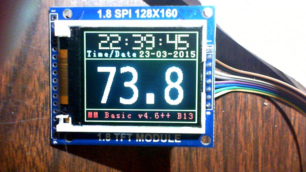

Firmware Update...
Thanks to Matherp, the 1.8" TFT LCD using the S6D02A1 controller is now supported..!
I penned up a simple time - temp program to test the newly supported unit...
2015-03-24_035743_1-8inch_LCD_B13_470.zip
However, while playing with it, the firmware seems to have the DS18B20 bug
where the displayed temp goes wonkey if the temp gets above 82 F...
All in all, a good nights work... Yikes, past my bedtime... More later...

  Quote  However, while playing with it, the firmware seems to have the DS18B20 bug
This is a bug reading the DS18B20 when CPU speed is 96 - works at 80 and below. I've had a look at it. 96Mhz is a special case as the CPU introduces a wait state for peripherals at that speed but not below but not apparently for the core clock used for timing usec pauses
In general peripheral intensive applications will work faster at 80Mhz than 96 although the difference may be not obvious from Basic.
Bug fix posted
Glad the S6D02A1 works OK Edited by matherp 2015-03-25

Posted: 02:45pm 25 Mar 2015
Good evening WW...
Yep, the Skinny running hard while making the color photons seems to cost you 92ma as read from a meter running from the USB +5vbus pin into your board. The 3.3v out you provide runs the display and the DS18B20 IC... Nothing else is in the mix, as there was no USB converter module connected during the test measurement... This is getting close to the max value the USB controller will let you have without asking for more... That's why I re-programed the FTDI setup table on the DIP-600-28 board to ask for 200ma as well as changing the "C0" pin to flash when traffic goes through...
