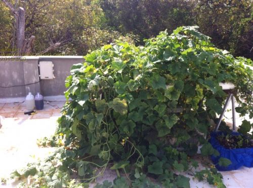

I am working on an automation system for my small recirculating hydroponic setup using a Wattmon. The idea is to have three different tanks with nutrients and acid, and dispense them automatically with small pumps when the ph or EC of the water go out of range. I purchased a ph probe and module with 0-5v output from China and that works well, but I built a TDS meter module based on a circuit off the web, and because it was a dual power supply based system I went for a voltage divider approach, so it has a 7809 regulator to step down from 12v, followed by a voltage divider to supply 4.5v to the system as ground. The op amps use this to generate a sine wave and the tds probe is part of the feedback of one of the op amps. Anyway, the point is that the tds probe puts 4.5v into the water and this messes up the ph reading completely.
This is the system, the cistern is behind with a 12v dc pump circulating water up. The box at the back is where the automation is meant to go.
I was thinking about how to isolate it and have come up with the a solution using two modules: a dc to dc converter with isolation, which steps up from 5v to 12v to power the tds circuit (us $3) , and a linear isolation module, 12v and ground on both sides, and 0-5v input one side with matching 0-5v output on the other side ($16). This would provide total isolation and hopefully solve the problem, but I will have to wait 6 weeks for them to arrive from China. Does anyone else have any experience with this and other ideas?

Thanks for all the suggestions. I think I will try and use the low cost isolated dc converter and tie the output +5v to the ground tail to generate -5v, and then as John suggested shift the circuit to ground. I was worried that the sine wave around ground would still affect readings but I will test it and report back.
