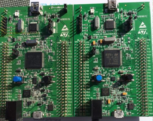

My ARMite board suddenly develop strange behavior and unpredictable response. The situation went worse as I tested board thoroughly. The larger code the more unpredictable results. After couple of days a new board arrived the problem was solved. See picture.
Older Discovery versions MB997A and B tantalum capacitors on positions C33 & C36 while latest board MB997C uses ceramic capacitors. As the B version of board was sitting in a drawer since 2011 the tantalum capacitors ESR went higher (3.9Ohm) when a fresh capacitor has ~1.1Ohm. I fixed board temporarily with replacement C33 and C36 for tantalum capacitors with low ESR and I purchased X7 2.2uF 1206 ceramic capacitors on Ebay.

  boss said  tantalum capacitors on positions C33 & C36
Bo
What are these capacitors used for in the circuit?

  Quote  What are these capacitors used for in the circuit
These are the VCAP capacitors required for the STM32 internal regulator - same use as the 10uF-47uF VCAP for the PIC32MX.

I opened Discovery BOM file and they recommended to use X7 ceramic capacitor size 1206 2.2uF/16V. I didn't have X7 capacitors at all so I have temporarily replaced these with the fresh tantalum low ESR 4.7uF/16V 1206 and I purchased X7 4.7uF/16V 1206 on Ebay (100pcs $4 + free shipping).

Bo, strange that they recommend X7 (I presume that means X7R as the ceramic's electrolyte?) Low ESR ceramics usually require the X5R electrolyte like we use with the MicroMites.

Totally agree with you, but see the BOM. Because the capacitors are easily replaceable I decided to test it.
@WhiteWizzard
I have no ceramic capacitor in 1206 case right now, so only way how to verify this theory was remove capacitors and check the ESR and compare with fresh one. I have couple of fresh tantalum 4.7/16V 1206 so I decided to temporarily use them while waiting for ebay package.
