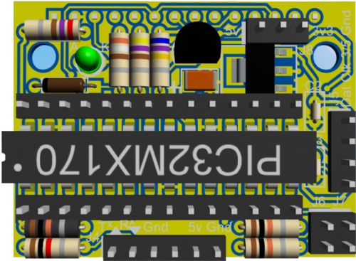

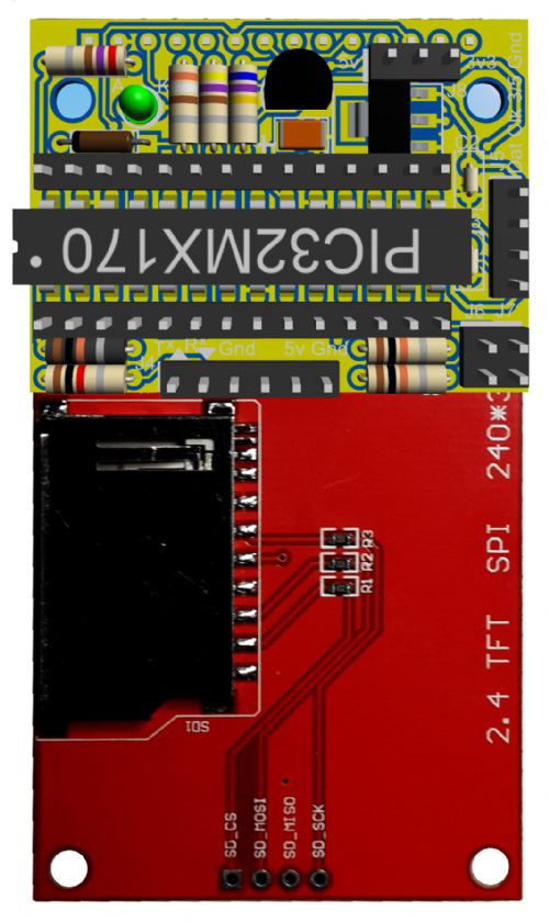

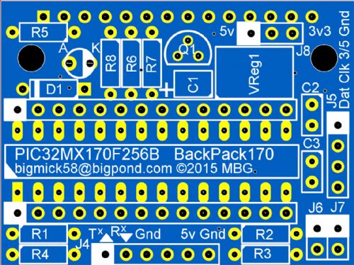

Hi All,
I have just sent off to get some boards made up for a BackPack onto those 2.4" SPI display panels that are so cheap on eBay.
These have a Pic170 28pin DIP and 3v3 Voltage Regulator with an I2C port and support for PWM backlight control (A long story but that cct killed a heap of my brain cells, It was more difficult than I figured it would be.)
If these work as well as I expect they will I intend to do an SMD version with a SSOP 170 and an RTC onboard and possibly a 44 pin version..
The PCB is 43mm x 32.5mm in size.
Some pictures..
Overlay
3D representation
Mockup of how it would look on an SPI panel

The 2.4" panel I bought is This one and I have bought a 2.8" panel like This unit as the pinout is the same, but as the 2.8" module is 50mm wide compared to 43mm for the 2.4" the mounting holes wont line up but electrically it still should be the same.

Posted: 12:04pm 08 Apr 2015
Awesome BMI..!!
I wanted to spin up an interface board for these touch units.. and .. BAM...
She's already done..!
Nice compact layout.!
You do fine work Sir..

Hi Zonker,
Thank you for the kind comments but I do not yet have one let alone tried it out.
I admit, I always try to squeeze the PCB real estate as much as I can. This one was very tight.. I really wanted to add another 3x1 jumper so that the backlight could be permanently jumper end to uMite controlled or 3.3 for constant backlight on.. But there was no room for it.. Even small solder links would have been difficult to add..

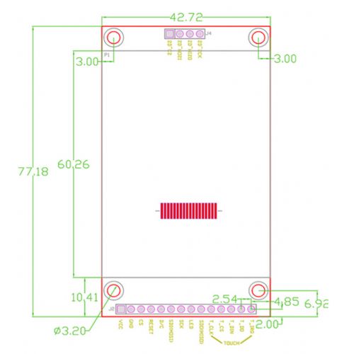

Allo Mick,
Eh mate what are the dimensions of that 2.4" tft screen mate as I do have a Hammond Case here waiting for the best solution.
Cheers Bryan
Posts: 2982
Posted: 02:38am 10 Apr 2015
Hi Bryan,
Here are the physical specs for the display I used... The 2.8" unit is larger and within a $1 of the 2.4" display..
I added it to a ZIP file so the details can be seen easier
2015-04-10_123759_SPI.zip

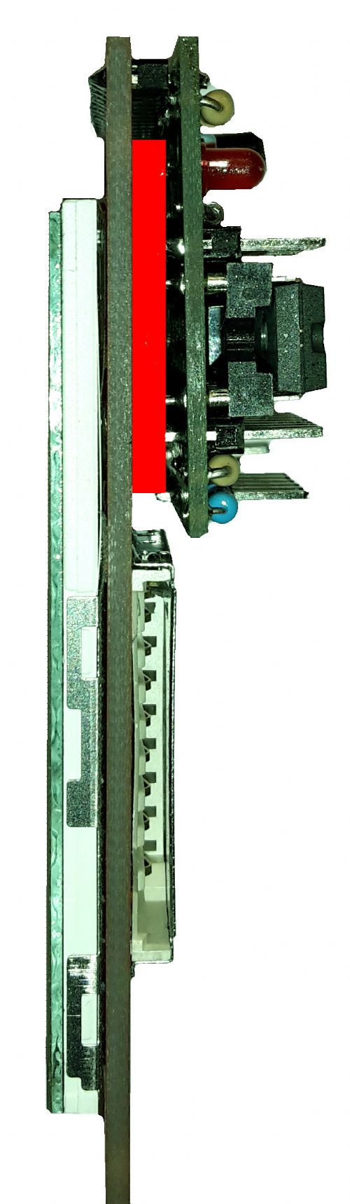

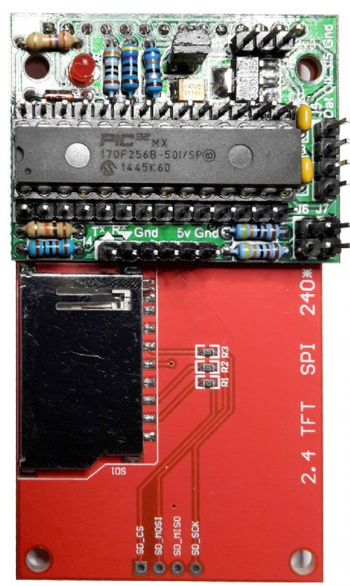

Hi All,
Just letting you all know that my Backpack170 PCBs arrived today and I have to admit I love them.
It worked `out of the box'..
I haven't yet done a manual but hope to get one out in the next couple of days..
When I have the manual I will add it to my `Micks Blatant Self Promotions' page.
A couple of pretty terrible pictures to show how it looks, the picture makes it look quite a lot wider than the screen , in fact it is only about 1mm wider than the screen. I have tried to use Through hole parts but I have opted for the SMD Vreg and the SMD VCap (a must anyway) as this has worked extremely well in my MuP boards. Of course I will be offering options of these two parts pre-soldered for those still a bit wary of SMD..
Note the Red block is showing where I used double sided foam tape to try to avoid any shorts between the boards, I probably suggest some sharkskin or tough plastic to fully insulate in the case of very rough treatment.

Posted: 03:09am 21 Apr 2015
Nice one Mick - looks great.
Best you get your best pigeon loaded up!!
