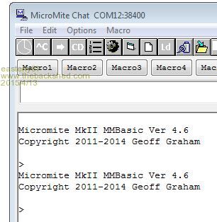

Doesn't the ds3231 use the gettime and settime functions of mmbasic. I tried to use them last night and got error stating their was no pfc8563 found.
I was able to set and read time without these functions. Is there something I'm missing?Edited by easterly81 2015-04-13

Or 4.6b!
Change log for Micromite MMBasic Ver 4.6b
  Quote  Extended the RTC command to work with Maxim/Dallas chips including the DS1703,
DS3231 and DS3232. This is in addition to the Philips PCF8563 which is already
supported. The RTC command syntax is exactly the same as in previous versions, the only change is that it will automatically detect and use whatever chip is connected to the I2C pins.
Please check if you can find a I2C device on &H68 (I2C Scanner).

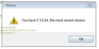

I just downloaded it 1.5 week ago i will check when it get home. When did this change or maybe i dl old rev.

Im up to date.

  easterly81 said
Im up to date.
That is not a message from a Micromite. You need to consider where you were and what command you made when you got that message. It may be from MMEdit or ....

Im sorry u guys meant firmware? I am running 4.6 so i guess it was to to buy a pickit3 anyways.

Well I borrowed a pickit3 and updated to 4.6b and all works. You guys are geniuses.
