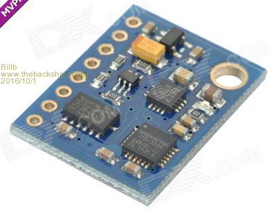

@BobD
  Quote  Thanks, it's amazing what can be packed into a chip. I often wonder how they construct gyros and accelerometers inside these chips.
This little beast contains a Compass, accelerometer and a Gyro all in a
package 2.2cm * 1.6. GY-85, Comms are I2C and is from DX.com for $11.00 Au
I have used this it with picaxe so would work with pic32s OK.
