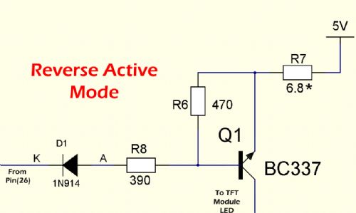

I then tried it with an NPN with collector to 5V and emitter to the LED and it didnt work.. in the process of swapping transistors around (My selection consisted of BC547, BC557 and BC337), I accidentally inserted my BC337 backwards so that it was as shown in the following image (which is the way that BackPack 170 is currently. It was `almost' perfect! After a couple of resistor value changes I got it working really well..
But Hey!! That transistor is BACKWARDs.. Thats not right.. But it works!! Hmmm what to do? So back to Dr. Google for reverse connected transistors and lo and behold it is not an uncommon design practice, there are heaps of references including this one from `Sparkfun' (search for Reverse Active).. So I released the board as it was, half comfortable with it..

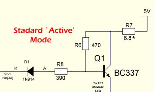

This made the purist in me revisit the design, so I bread-boarded it again.. Proved that the REVERSE ACTIVE worked and worked well but this time I reversed the transistor into a more traditional layout and bugger me.. IT WORKED.. I have since built a BP170 with the transistor reversed (well in actuality NOT-Reversed) and can confirm it does indeed work.
Hmm, why didnt this work the first time I tried it?? I can only assume it had something to do with the breadboard design and some component not connecting to the holes in the breadboard correctly.. (I usually use solder proto boards but this time used those solder-less ones. I remember Phil's warnings about these a month or so back.. I can now concur with his sentiments.
What does all this mean?
Well it means that transistor, as shown, is actually backwards but does work and is unlikely to be damaged due to the low 5V max supply, and does seem to be a (at least semi) legitimate design. I will alter the manual to suggest mounting the transistor 180 degrees to get it to work in standard configuration.
The new circuit would now look like this.

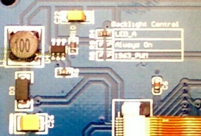

It is worth measuring the current going into the LED pin on any specific display before getting too clever with this.
On some displays (e.g. the SSD1963 mounted boards) the LED pin is a logic signal that switches a circuit that actually drives the display. It draws almost no current. It is perfectly OK with this display to connect "LED" directly to a PWM pin on the Micromite and use this to set the backlight.
In fact the SSD1963 controller has its own PWM output which is optionally selectable on the SSD1963 PCB.
The initialisation code for the SSD1963 in the ARMmite and the MX470 turns on this PWM and sets it to a level that on my display gave optimum brightness for minimum duty cycle. At some stage I'll write some code to expose this facility as a user function.

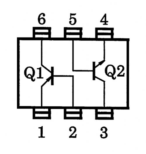

In reality I agree a 2 transistor circuit would have been better but I didnt have the room for 2 transistors and all the bias resistors unless I went SMD which I tried to avoid. I have these neat little SMD chips (3mm x 2mm that have the follwing footprint but these would have made the board difficult to solder for many people.

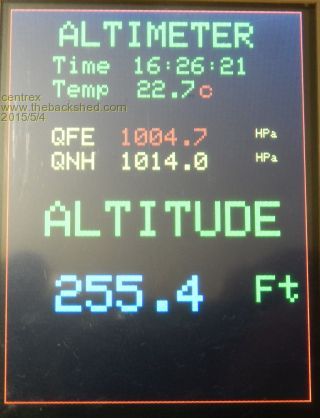

One thing to remember the tft modules Mick's board is designed for runs at 3.3volts.Mick's revised circuit while switching the 5volt railensures that only 3.2 volts ends up on the led pin.
I have it running just a single led with no problems as a test.
Bigmicks driver board matherp software driver BMP80 pressure sensor, my altitude a bit south west of Sydney.
CliffEdited by centrex 2015-05-05
Cliff
