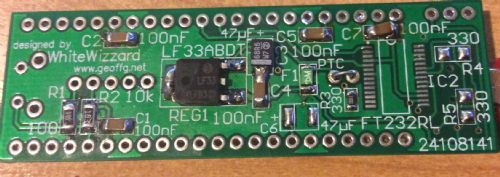

Hi all,
I've been trying to build up some 44-Pin micromite modules as discussed in the Aug 2014 Silicon Chip.
I should note that this is my first extensive attempt at surface mount soldering.
Now the first one I built up did nothing at power-up. After measuring voltages I found the that voltage after the PTC was only 1.6 or so. I did have some trouble with the PTC during soldering so I reasoned I had damaged it and just bridged it (stop laughing).
This didn't fix the problem, so I decided to build up the second module minus the two IC's. I figured this would give me a chance to measure all the voltages we're correct.
To my surprise, this one ALSO came out with 1.6v after the PTC. I've checked all the soldering and it all looks ok. Good joins etc.
Any ideas what i've done wrong, what to check?

Ok - think I should step in here!
Please check/answer the following:
1> Can you remove the 2-pin jumper (near the USB socket) and measure the voltage coming into the module from your power source
2> Are all components mounted or are some 'left out' for now (other than the 2 ICs you mention)
3> Can you submit a close-up photo of the 'completed' unit with the 'bridge' in place of the PTC
Will walk you through things if you stay online . . .
WW
Posts: 2991
Posted: 10:27pm 07 May 2015
Q4> Can you check all connections on the USB socket.
The fact you are getting 1.6V is a figure that can derive from 5v in less 3v3 required . . . .
Waiting for feedback from you before next suggestions

here's a photo.
Yes, C7 is pretty crappy but I swear it looks ok under magnification.
The regulator has the markings LF33 GKLFB323. It looks damaged on the left side but that is just flux. looks ok now i've wiped it.
and yes, I've put a bridge wire in, instead of the normal jumper at this point.

Posts: 2991
Posted: 11:23pm 07 May 2015
First observation is that the47uF cap across the vReg is the wrong way round (or at least I believe it is).
On SMD caps, it is normally the +ve side that is marked (in this case with the white line). This is the opposite method of 'assumed' marking to through-hole caps where the -ve lead is marked.
Anyway, that said it shouldn't make a difference but is worth trying briefly . . .
Let me look more at the photo and get back to you with anything else

Posts: 2991
Posted: 11:25pm 07 May 2015
If you are mid way through turning the cap around then please LEAVE THE CAP OFF first and quickly measure the voltage on the 3v3 output again (this eliminates any soldering issue around this cap (providing you clean the SMD solder pads first))
TWO MORE OBSERVATIONS/POINTS:
1> Have you got a good solder connection on the vReg on the 'big' GND pin on the left hand side (and not just on the two pins on the right hand side). Your photo shows it is soldered but it needs to be a good join (as this is GND for the whole circuit).
2> Is there anything in the PTC space? It looks like there is solder there but no component - I know you have made reference to the PTCs on both modules - I just need to be clear on what you have on the module in the photo.

CarlRanson
Joined: 08/05/2015
Posts: 30
Posted: 11:31pm 07 May 2015
  Quote  On SMD caps, it is normally the +ve side that is marked (in this case with the white line). This is the opposite method of 'assumed' marking to through-hole caps where the -ve lead is marked.
OMG, who came up with that scheme....
and BINGO, that was the problem exactly.

I think that there is a 3v3 Regulator on the underside of the PCB, What part Number is it? I think by looking at the track layout it should be MCP1825S or MCP1826S... If you put an LM1117 instead the pinout is different..

Posts: 2981
Posted: 11:48pm 07 May 2015
Yes,
That Cap IS backwards.. I was writing when the picture of your board came in.. If you zip the photo and upload it it we can then get a better quality picture of your board.
It looks like you have the correct VReg installed but I cant quite read the number on it.
I cannot see anything else of concern..
