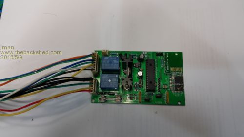

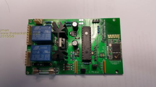

I thought I would share my latest project.
Micromite MKII HC05 Bluetooth Car Interface

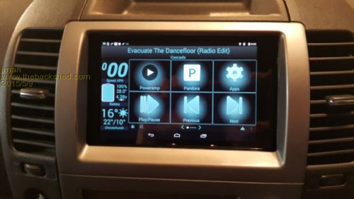

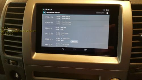

I have Nexus 7" Tablet in my car hence the project

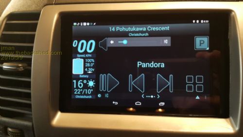

This device is a Bluetooth car interface for a Android Phone / Tablet
It sends a code via Bluetooth and this is used by an Android application to make the phone or tablet perform various functions
It has the following functions.
12v Relay output to Amplifier remote delayed to avoid thump on power up
12v Relay output for reverse camera

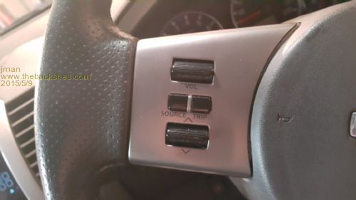

Analogue Steering wheel interface (Buttons press to code via A/D)

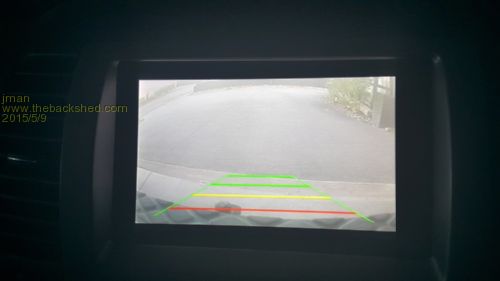

Reverse camera control via +12v trigger from reverse light
Rotary encoder for Volume control
Press Button (Incorporated into rotary encoder)

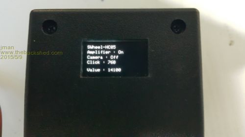

Each function sends a different number to the Android application
Steering Wheel Buttons (Depends on resistor values in car)
Phone triggered 10000
Phone call complete 10100
Reverse +12 input 11000
Reverse complete 11100
Dash Switch #1 1st press 12000
Dash Switch #1 2nd press 12100
Dash Switch #2 press 15000
Dash Switch #2 release 15100
Rotary Encoder right 14000
Rotary encoder left 14100
Rotary Encoder switch
Long Press < 1 second 13100
Short Press > 1 second 13000
Long + Press > 8 seconds reinitialise Bluetooth
Then just because I had a .96" OLED display I added that so
you can see the codes sent when setting it up in the car
(Thanks to Peter for code)
The PCB was kindly designed by Grogster (Many Thanks G).
The code,PCB's and Android Application are available should anybody be interested.

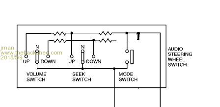

SetPin 2, INTB, ReadAD
This will set pin 2 as an any change interrupt. (As you already know)
The source is the Steering Wheel buttons
So if a button on the steering wheel is pressed the SUB ReadAD is run
and then we use SetPin 2, ADIN to set the pin to read the analogue value once we have read the analogue value we run SetPin 2,INTB, ReadAD again.
The steering wheel buttons have quite low value resistors going to ground hence the
ADVal * 100 we now have a value for each button.
Hope that helps

Thanks for the reply! In your ReadAD routine, you are setting the ADRead pin (pin 2) to an analog input and in the same routine you are doing SetPin 2, INTB, ReadAD. I guess that is confusing me as I thought that SetPin2, INTB, ReadAD makes the pin a digital input to trigger an interrupt. Maybe it would be clearer to me if I knew what the resistor circuit looked like. Does the SetPin2, INTB, ReadAD also work with a change in analog voltage?
Also in the same routine you have...
Do While Pin(ADRead) < 3.0
So I am assuming the circuit attached to pin 2 will provide a voltage greater than 3v?
Sorry for all the questions. I am just curious now.
Thanks Again!
jman
Joined: 12/06/2011
Posts: 711
Posted: 10:46pm 08 May 2015
Hi
Yip correct I am using the analogue voltage as the source of the interrupt as this goes low enough to be seen a digital low input.
Correct this checks if the voltage is greater than 3v as this
indicate that the steering wheel button has been released.
Not shown on the circuit diagram is a 10K pull-up resistor to 3.3v
So when the steering wheel buttons are open circuit the value of the AD will over 3 volts
Hope that helps
Jman

  jman said   Micromite MKII HC05 Bluetooth Car Interface
I have Nexus 7" Tablet in my car hence the project.
It sends a code via Bluetooth and this is used by an Android application to make the phone or tablet perform various functions.
A really nice job John - I'm not sure I've got what you're doing quite straight though. Have you installed a Nexus 7 into the dash or was it already there? I guess this is running the Android app and that sends the bluetooth commands to the uMite which then does all the other I/O control - or have I got this back-to-front? Was the analogue signal from the steering wheel already there or did you modify it all?

  jman said  A really nice job John - I'm not sure I've got what you're doing quite straight though. Have you installed a Nexus 7 into the dash or was it already there? I guess this is running the Android app and that sends the bluetooth commands to the uMite which then does all the other I/O control - or have I got this back-to-front? Was the analogue signal from the steering wheel already there or did you modify it all?
I'm amazed you've kept it all so neat
Greg
@ Greg
Thank you for the comment
The car originally had a 6 CD in Dash Player. I removed it and installed the Nexus in it's place. (Thank goodness for my 3D printer). The Umite sends the data TO the tablet and the Android app process's it and preforms the relevant command.
The only mod I did to the Steering Wheel controls was to add a series resistor.

The PCB as a ground Plane pour. The PSU is just a LM7805 and LM1117-N for the 3.3V. The board has lot of decoupling caps and the regulators have the required caps. Polarity protection is provided by a 1N4007 in series with the 12v input
Hope that helps

Neat project. I am interested in how the rear vision camera video is interfaced/works with the Nexus as a display.
Gerry
Latest F4 Latest H7 FotS
jman
Joined: 12/06/2011
Posts: 711
Posted: 04:02pm 09 May 2015
@ Gerry
This is done using a USB video grabber the Android Kernel I am using has the driver included.
The USB grabber was sourced from here USB Video Grabber
And lastly I use an Application called EsayCap that can be obtained from the Play Store here EasyCap
