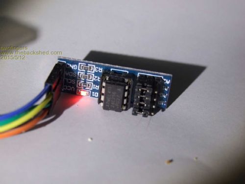

If it has to be an affordable solution then I would recommend a 24C256 EEProm (32KBytes, costs ~1$ from china).
Endurance: Good enough for more than 20 years!
Be not afraid of page boundaries!

When you say that one has to be careful of page boundaries when writing (eeprom), do you mean if you do a sequential type of operation? I have been playing with the code found HERE, just using the byte read and write from particular address and it seems that you can write to 4096 addresses. Can you give me an idea of what you mean by the page boundaries.

Hi TwoFingers, I just saw your post on the 24C256. Looking at the data sheet, it says...
This device also has a page-write capability of up to 64 bytes of data. This device is capable of both random and sequential reads up to the 256K boundary.
Does this just apply to doing sequential type writes where I am assuming that you set the start address once and spit out a bunch of data and the chip increments the address automatically? But if you send an address and data byte (one at a time) there is no problem with writing and page boundries?Edited by viscomjim 2015-05-13
That's correct!
Edit:
To care about "page boundries" is only important if you use "fast write" (writing more than 1 byte at the time). "Fast write" is especially usefull if you need to (over-)write many data (eg erasing the whole EEProm). I use "Fast write" in eeErase().
I think it is the job of the library worrying about the details.
MichaelEdited by twofingers 2015-05-13
