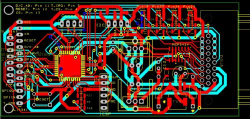

Posted: 01:12am 03 Jun 2015
Having got gauges working nicely the next step is to design a PCB that can connect directly to the TFT display and has a flexible I/O capability
2015-06-03_103225_Instrument_-_PCB.pdf
2015-06-03_103358_Instrument_Schematic.pdf
The idea is that the PCB will attach directly to either an ILI9341 or ILI9163 with them mounted vertically facing away from the PCB and centered on the PCB. This will allow the complete unit to be suitable for panel mounting in an appropriate enclosure.
There is a single 26-pin DSUB connector (the next bigger version of the VGA DSUB) which is used to power the board and to bring all of the I/O ports out.
The connector supports:
4 x 18-bit ADC channels with 8x programmable preamp, these can be used to measure directly thermocouples or strain gauges
4 x general purpose analogue/digital I/O ports with optional pullups, pulldowns, RC filters and GND and VCC connections. These can be used for DS18B20, thermistors, light sensors etc.
1 x port to support external IR
1 * relay/warning light drive circuit
In addition the PCB has a I2C header with the correct pin mapping for directly mounting vertically a DS3231 real-time clock module or an EEPROM (or other I2c device) on a daughter board.
The LED pin on the TFT can be connected via a shorting link directly to VCC or to the PWM2A port of the Micromite via a P-channel mosfet.
A voltage divider and RC filter is provided to allow measurement of the incoming supply voltage using pin 19. The supply itself passes through a current limiting resistor, and diode to protect the circuit, in addition a bidirectional TVS is used after the resistor to remove any voltage spikes. The primary regulator will be a LM2940 which is specifically approved for vehicular applications.
ISCP and Console ports are available on the PCB
I'd appreciate any comments and ideas

Posted: 05:06am 03 Jun 2015
I tried to read the schematics but i can not really find all the connections.
A missing one is the MCLR. I can not find to what this is connected in the schematics.
I can see it in the pcb layout but that is way to difficult to see if there are design issues.
I know you know enough about electronics to not make obvious mistakes but it never hurts for a set of extra eyes to go over it.
Might it be that not all net labels are shown in the schematic?
Posts: 12010
Posted: 06:02am 03 Jun 2015
TZ
Designspark only labels wired connections if you ask it to. Connections where you just specify the net name are shown properly.
I'll go though and label up some more of the wires. The only other one I can see at the moment is GND on the ICSP. Can you see any more?
Net MCLR (pin18) does connect to pin 1 of the ICSP header but you are correct this can't be checked on the schematic.
Thanks for looking, you are correct we can all make mistakes!
Peter

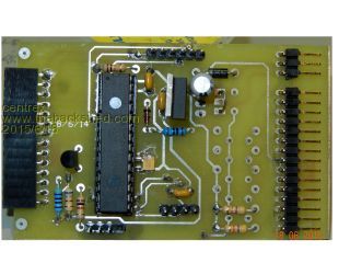

Posted: 10:50pm 17 Jun 2015
Inspired by Matherp's io board but not having a 44 pin pic chip I had to use a 170 and a 2.8 touch lcd screen.
The picture below is what I ended up with, it is based on Bigmicks BP170 with the added icsp as well as the ability to fit series resistors on the the remaining two analog ports, pullup resistors on the digital ports. All the inputs can have bypass caps fitted, it also has two voltage regulators so can run of 5 or 12 volts. The board is homebrew double sided but not plated through so it requires soldering on both sides as well as a few jumpers.
Unfortunately it appears that Riston coated pcb material is no longer available here in Aus.
The tft screen plugs into the left hand socket the pins at right are power at the top with io pins underneath these pins also have ground and plus 3.3 volts on alternate pins.
Cliff

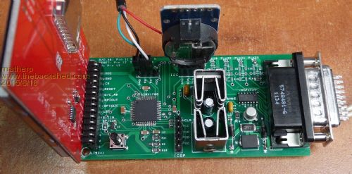

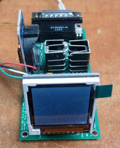

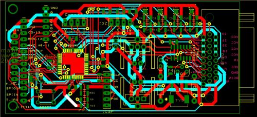

Posts: 12010
Posted: 03:00am 18 Jun 2015
My boards arrived yesterday so I've built one up to test. Of course for a production environment the display and the RTC would be soldered direct rather than socketed and the board would only be populated to the extent required.
Everything seems to work well with the ILI9341 or
ILI9163.
There are a couple of changes I need to make for version 2. First I should have had a decoupling capacitor across the power pins of the MCP3424 ADC. Second, the silkscreening for the diodes is the wrong way round (thanks RS!).
In addition I've added a header for an openlog to the layout.
I'll continue to test and make changes to version 2
Update
Unfortunately the PWM control of the backlight doesn't work. I knew it might be an issue as I am trying to turn off a p-channel mosfet connected to 5V with a gate at 3.3V - it stays on
The next version will have to use a npn transistor to switch the mosfet
if required. If anyone wants one of the current version PCBs then send me a PM and and I'll pop one in the post. I have 8 spare.

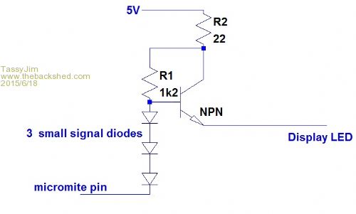

Posts: 6624
Posted: 12:09pm 18 Jun 2015
Peter,
This is the circuit I used with one of Micks BP170 boards.
With the values shown, the maximum LED current was ~10mA. This was as bright as I wanted but I think the 22 ohm should be less and probably the 1.2k as well. I also think that 2 diodes would work without any risk to the micromite pin.
I need to do a breadboard and run some more tests.
I would also put the 22 ohm resistor after the transistor but the board layout didn't suit - but that might mean I do need the three diodes for switching ON.
Edited by TassyJim 2015-06-19
