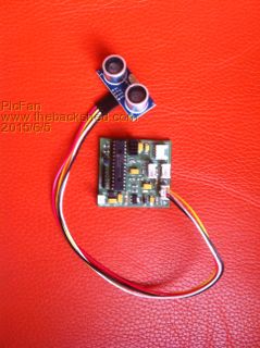

Hello Geoff !
I have a problem with the "distance-command" with V4.7B3-8, i read only 0.4 again. With the Version 4.6 the "distance-command" works perfect.
Thank you !
Wolfgang
Posts: 3369
Posted: 02:19am 05 Jun 2015
Nothing has changed in that area so it should still work OK.
Can you be more specific as to the problem and the configuration that you are using. Also, what has changed between your 4.6 and 4.7B8 tests.
PicFan
Joined: 18/03/2014
Location: Austria
Posts: 133
Posted: 02:30am 05 Jun 2015
  Geoffg said   Nothing has changed in that area so it should still work OK.
Hello Geoff !
I use the same PCB and the same hardware, i change only the PIC !
trigPin = 17
echoPin = 18
DO
dst = DISTANCE(trigPin, echoPin)
PRINT dst
PAUSE 1000
LOOP
Thank you !
Wolfgang
Edited by PicFan 2015-06-06

I have the same problem with the distance command in the version 4.7.B8.
Is used the module HC-SR04.
Trigger is at PIN 21
Echo is on PIN 22
With the oscilloscope can be seen that no defined level is present at each port.
With a pulldown resistor of 3k3 to the trigger wire of the trigger pulse is detected by the module.
It then responds on the echo line. This is not evaluated by Mikromite.
With the Version 4.6B and connected to the same pins, the module is functioning properly.
Thank You Very Much.

Hello @WW
I have try with 3 US-Modules (HRS-04) and 3 new PIC,s ! With all 3 Module and PIC the same problem. The V4.6 work without problem, the V4.7B3-8 works not.
Thank you !
Wolfgang
